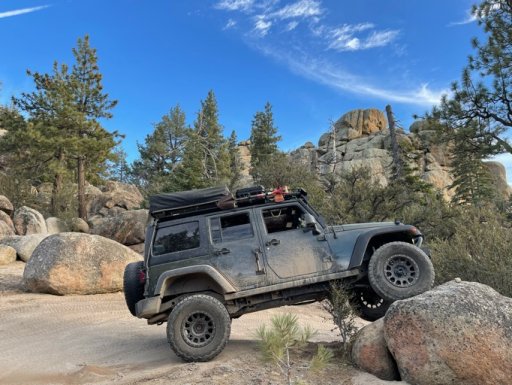

Like several have suggested, I’m running the tereflex outback overland suspension with falcon 3.3 shocks on 35s. It’s a firmer ride when running empty but nice when loaded down. Still plenty of flex to get sketchy on trails LOL.
Reactions: sabjku
That's a great pic!
Reactions: Iwata77
That's a great pic!
Thanks! Accidentally took the wrong line but it worked out
