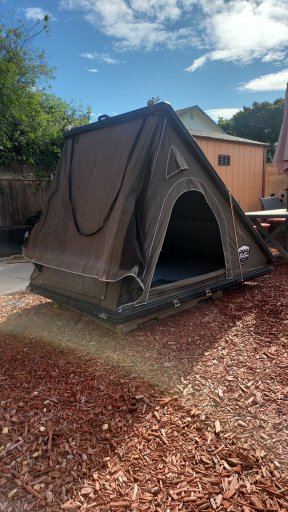

I have a Mt. Hood roof top tent, it has water trapped inside the upper clamshell section not to be confused with the sleeping section. How do I dry it out? Is there a specific location on the tent to drill and drain the water without damaging the integrity of the tent? I can hear the water sloshing around when im driving. Any experience or insight is welcome.

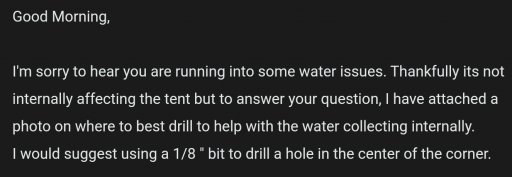

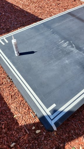

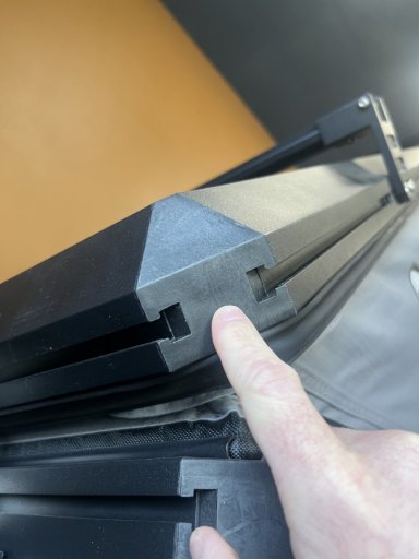

Follow up to my issue. Good news. Customer support responded. I have attached the following images in hopes it may help those who are experiencing a similar issue.
