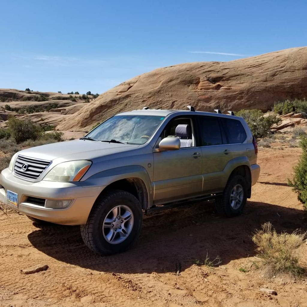

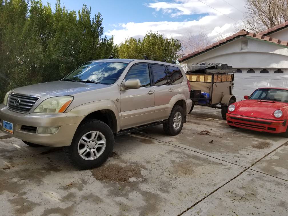

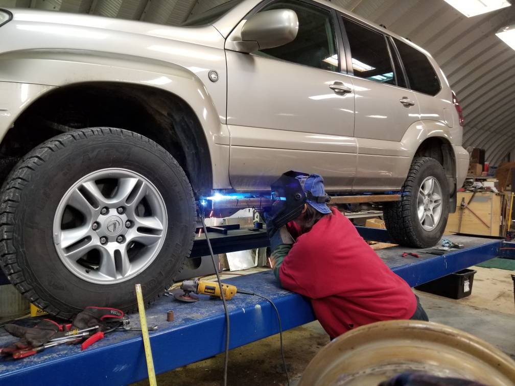

Building a GX470 as a project. Have not done a lot but it works very well. I put some 265:75:17 on it and a 2 1/2 inch oldan emu lift kit with some equalizer spacers. Have not finished my roof platform but I am making progress. So no really like any except the rhino platform but by the time I make my mods I might as well build the whole thing.

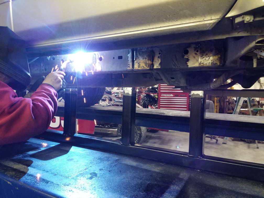

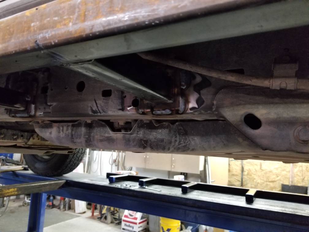

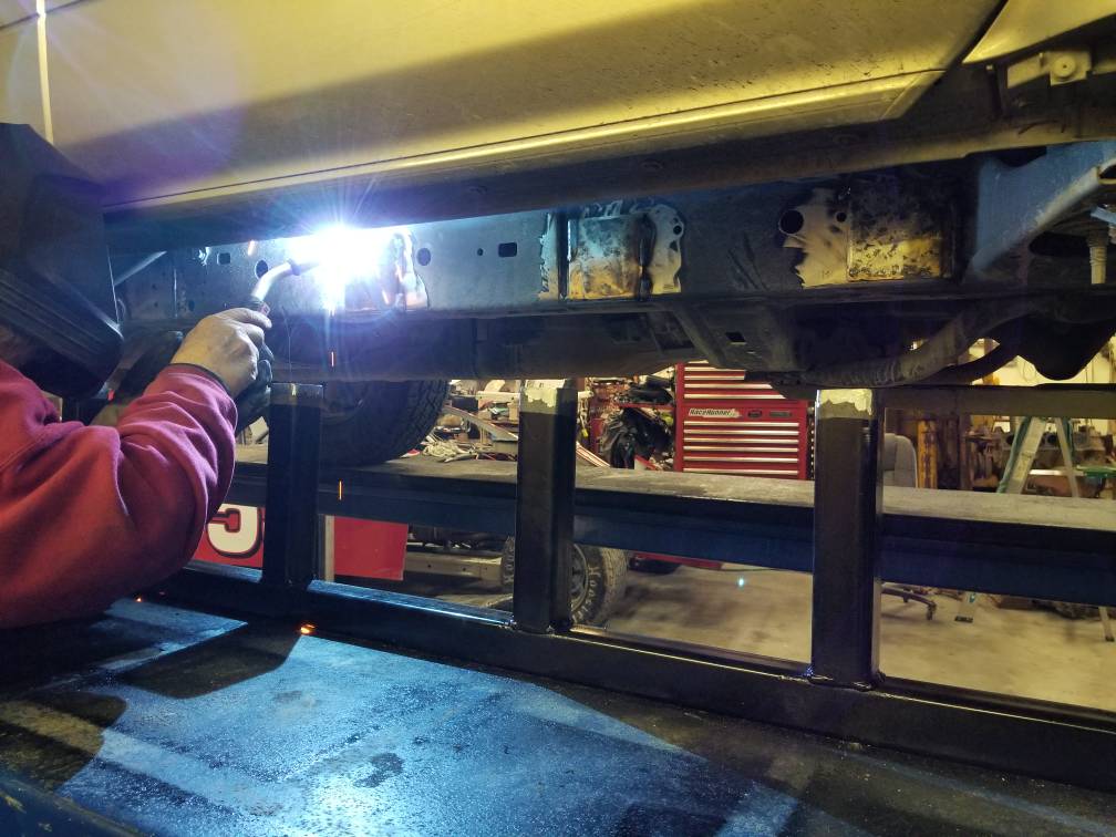

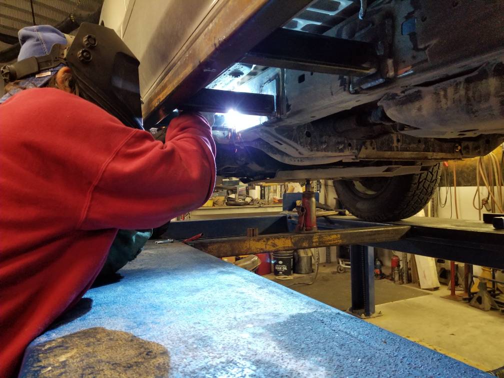

Just finished my weld on rock sliders
Made some 4x4 plates out of 1/8 strap, cut up some 2x2 .120 wall steel tube and had my buddy weld it up. Worked great and strong as hell. After I get back from Moab I will nend up some 1 1/2 thick wall DOM tube and put on the square tube. Need some step for my wife and to get to the rack on top.
Here are some pics.
Sent from my SM-G950U using Tapatalk

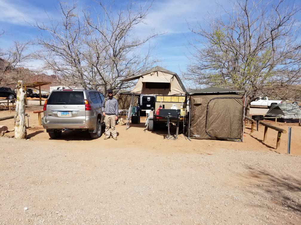

Still have to organize the trailer, not to sure what I want to do, Moab and Overland Expo will help with that. I am trying to keep the GX light as possible, some big conflicts there. I guess a behind the stock bumper winch with a rope will have to do for the front. Maybe a tube rear bumper.

Looks great! I cant wait to see the progress. I have a GX and have similar plans/expectations. My sliders are currently sitting in my garage waiting to be welded on and will be doing lift/tires shortly after.

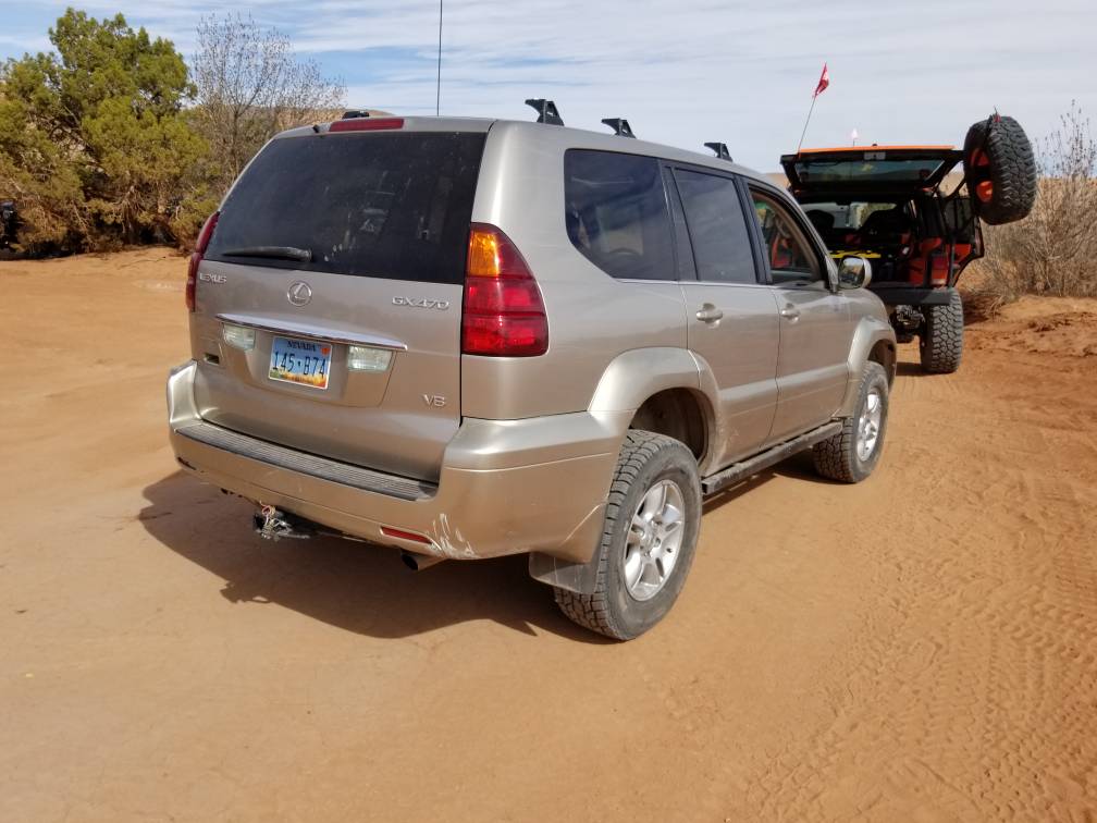

GX does very well, sliders were helpful on Hells Revenge in Moab. Dropped the tire pressure to 20 and traction and track lok was amazing
Kept telling the jeepers O was lost looking for Starbucks
After the first obstacle I was warned not to do and proceeded to do easily everyone just watched. I was very impressed. Have just about decided I can go about anywhere, biggest constraints are clearance and no body damage.
Think I picked the right platform
