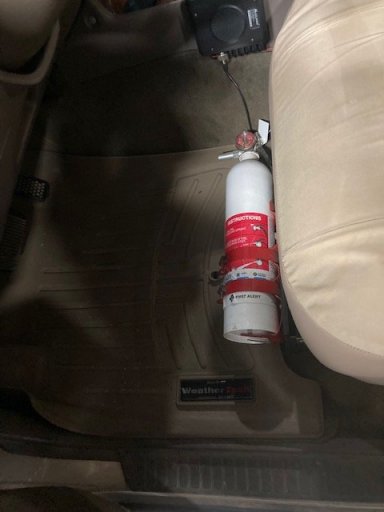

I've considered one, but it was a passing consideration. My stock rear windows slide nicely to access a couple of things I keep near them. I read that you are considering keeping a fire extinguisher back there. I would suggest keeping your extinguisher very close by. Wits End makes a carrier that keeps the extinguisher very close to you. I keep one at my feet and another in our trailer on the rear kitchen deck. IMG_0895.jpg
