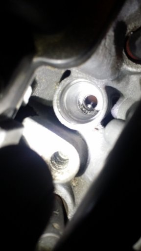

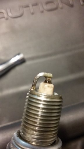

On my way to work my Jeep gave me a P0304 code. After inspecting it looks like I may need a tune up. So that's what I did last night.
View attachment 2179 View attachment 2181
So after I changed all my spark plugs I went for a drive. When I turned the Jeep on the error code was gone. After a minute of driving I came to a stop and saw a lot of grey smoke coming from my tailpipe. I pulled into a parking lot to make sure I was not on fire. It smells like burning paper! And only out of my tailpipe. What would cause this? Please help.
