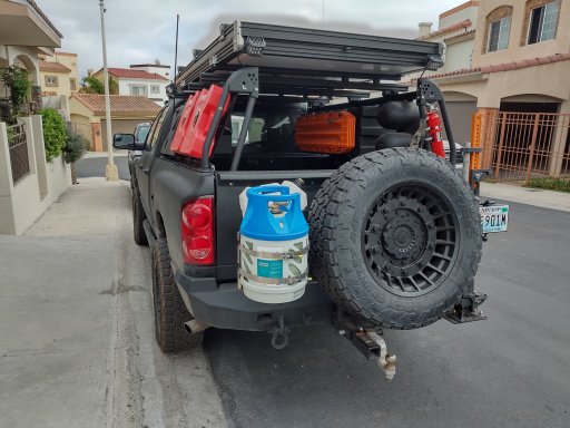

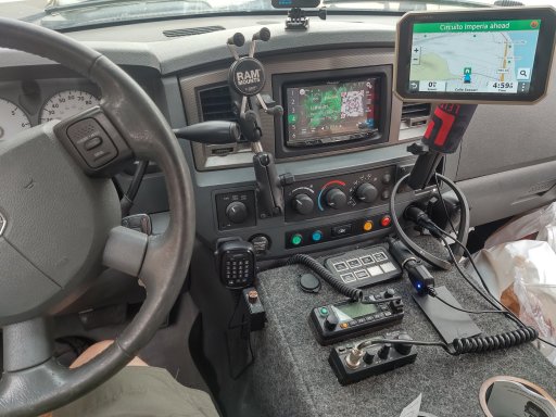

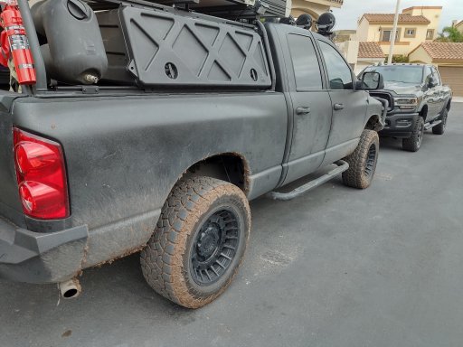

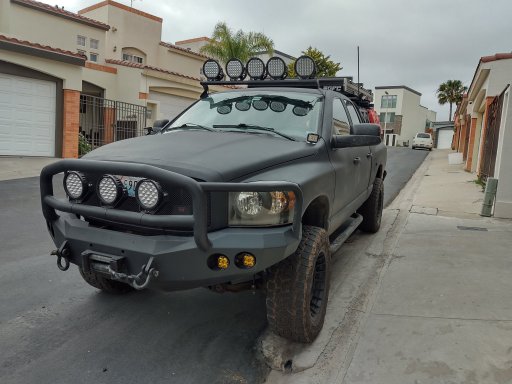

Got a awesome 2008, 130K miles (extremely low driving miles vs year), 1500 Quad Cab Ram fully outfitted, ROCK SOLID 5.7l HEMI. has Lietner modular, RIDg ultimate swing away, 5 new TOYO all terrain and matching 5 x 20" FUEL wheels all less that 500 miles on, K&N air, Thrustmaster 3" exhaust, smoking sound system, GFC with 220wat solar panel, Dometic CX90, 6" Rough Country lyft for 35" Toyos, new brakes rotors and pads, pulse one extra set of un used rotors. UHF/VHF digital FM radio pulse CB, Procomp 3" LED on bull bar, 5" over windshield, 4 x Baja Design amber fogs, 2 x ProComp ditch lights and 4 x ProComp exterior in camp lights, Black Rapter liner, front and rear Road Armor "Lone Star edition" steal bumpers, Warn 1200 winch, man/BT. Clean title,. single owner ordered from factory, via Carson Dodge Carson City Nevada. Oil changes every 4k miles or four months which ever came first, all service completed either by Bob Baker Dodge Carlsbad CA., Balboa Dodge San Diego CA. or Pierson Dodge National City, CA. "Mile of Cars." Again SOLID this truck has never broke down, ZERO warranty issues. Bough when they offered a COMPETE Drive Train (both pumkins, transition and engine) Warrenty. Which explains why it was made to last. lol
40k non negotional, basically you are getting the truck at $0, paying for only equipment. Again no issues, no worries about selling, sound truck, but selling will advance my 2022 Powerwagon to a Prospector XL $24k and my Alucab $33k price tags..
