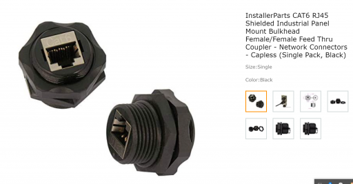

With the MXT275 you can put the body of the radio anywhere! Using a cat6 cable and a RJ45 panel jack you can mount the body anywhere in the vehicle and just have a clean jack in the dash to plug the mic into.
On my XJ the body of the radio is in the very back in the radio box with most of my other radios and the mic is between the front seats, works great. Of course where you want to mount your antenna will likely play a role in where you mount the radio, my antenna is on the very rear of my roof rack so it worked out well that I could mount the radio so close to the antenna and not have to run coax all over the vehicle.

I have not noticed much heat from the radio, does not have a fan in it. In the WJ, I removed the pull out cupholder located in the rear of the center console and mounted the radio in its space. I left the drawer face off so there is some ventilation. All the wiring runs through the center console, with a cat 6 cable connecting the radio to the bulkhead fitting obtained from Amazon that I located in a dash panel.
In my Ram truck I located both Ham and GMRS radio bodies under the forward tray in the center console, been almost 2 years and no heat issues or failures.
I use these bulkhead fittings for all the microphones on my radios with detached faces or all in one mics, really helps to keep the cab clean looking and prevents damage to cords run thru or under things.
