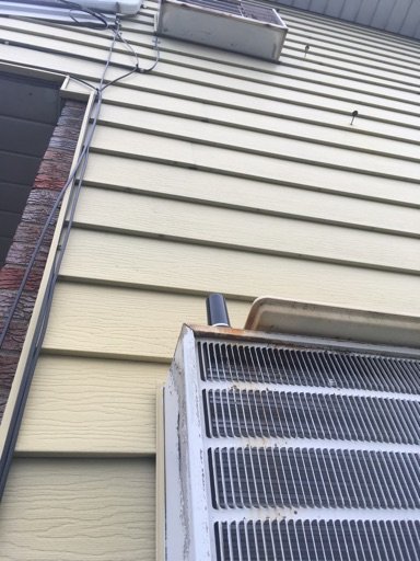

Those ghosts antennas are GREAT on GMRS. On my home radio I got an SWR of 1.2 on GMRS with this antenna. I wouldn’t recommend for VHF but I am impressed with it for GMRS and of my all the antennas I have at home it’s the one I use for GMRS. So discreet, my neighbor upstairs doesn’t realize it’s outside his window. Most people don’t even realize it’s on the roof of my truck.
Correct me if I’m wrong but I think it is a 1/4 wave at 462mhz which should help to reach GMRS repeaters or if you’re in a valley.
I know firestik is planning to release a GMRS 1/4 wave next month which I can’t wait to get my hands on. I think most GMRS users are probably group trail riders who might (might is the key word) benefit from a 5/8 wave. But 99% of the time I think a 1/4 wave like the ghost would be best.
