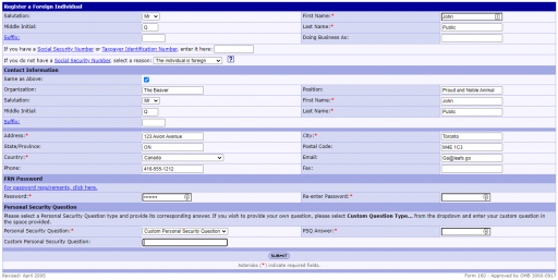

Similar to another q posted recently. We'll be travelling around the US and would be bringing some GMRS radios. I checked and see the requirement for a license. I started the process but get hung up on the application due to no US mailing address to input into the form. I answered all questions even saying I was a foreign national or some other wording when getting my FRN.

When you start the FRN process on CORES, you're asked if this is for a business or personal, and also if your address is within the US. Select NO, and the form becomes different. This should allow you to complete it. Note that Canadian GMRS and US GMRS equipment requirements are different, and specifically that in the US, you're allowed up to 50 Watts on channels 15-22 (and repeaters), and 5 Watts on channels 1-7. You're also allowed to operate either wideband or narrowband (most are wideband). The rules say you should use type-accepted GMRS equipment under Part 95E, but most people I know just use modified ham rigs.
