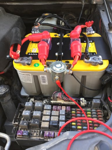

I am not positive as I have a different brand but I don't believe they do have the battery protection or at least didn't in previous years. I had to jump start a friend of mines rig because his killed his battery and he was worried about it so would have had it set if it had the feature.
You don't need to go out and buy an expensive dual battery setup. I built my own and apart from the batteries and mount don't think I spend $100 to run dual batteries.
This pic was taken during the install. Everything was complete but was wiring up my 12v trigger for the solenoid.
I'm not very electrically inclined which is why I'd lean towards getting a kit. However for now I think I'm leaning towards a solar setup to charge in the meantime because the kit is so expensive.
