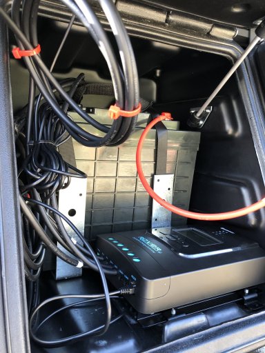

I can’t speak for the OP, however I run a separate lithium battery pack that power the fridge. I get two days without charging the battery. Takes 6hrs to charge and I have it under the center rear seat. I also have a portable solar panel I throw on the roof at work that charges it daily. I personally use a Flexopower power battery but I wouldn’t recommend it.

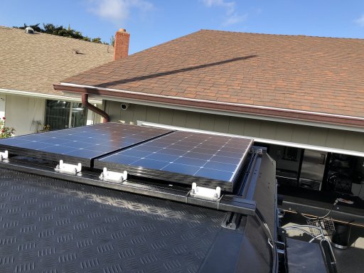

Getting ready for a Dometic fridge. Just picked up a Renogy 200 watt solar panel kit and a 100 amp iron phosphate lithium battery. Hopefully it will be enough juice. Mounting tomorrow. Will post pictures.

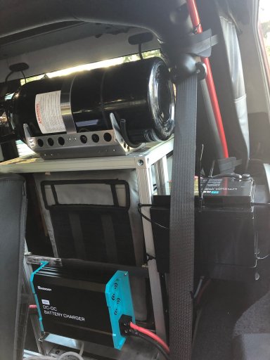

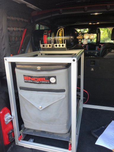

That should be fine - I just installed a renogy 50 AH LIPO and get 2-3 days out of it with my Engell. Installed in the back along with a 40 amp DC/DC charger .

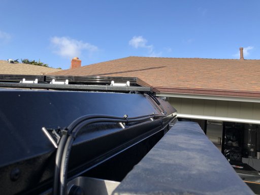

Just finished installing my 200 watt solar panels...Renogy premium 200 watt kit. Now for a Dometic refrigerator and rig will be done!
