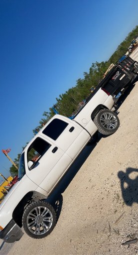

Quick question hopefully someone can help me out. I’m currently on a 6inch lift turning 24s on 35s with no problem. I want to take the lift off and be able to turn 35/12.50/20. What will make it possible for me to do that without having the 6 inch lift??

I don’t do too much off-roading. Only time i do a little bit of off-roading is for deer season. And even then it’s very seldom that i drive my truck. It’s a 2005 chevy silverado 1500. The 24s were for more of a look that i liked. This is what it is right now.

The truck has no squat in it. it’s 6in in the front and the back. I want to come down at least two inches but ik that’ll make a big difference on whether i can fit the 35s or not.
