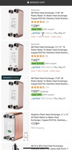

Hello! What a cool Forum. I’m in the process of installing a hot Shower set up for camping utilizing a plate heat exchanger, 12 V pump,mixer valve and all the necessary hoses and fittings. I just installed a new four core all aluminum radiator and realized that I had to unused ports on the passenger side used for trans cooling lineswhich I don’t need. Is it possible to use that as my heat exchanger for my freshwater or should I just stick with my plate heat exchanger that I was originally going to use?

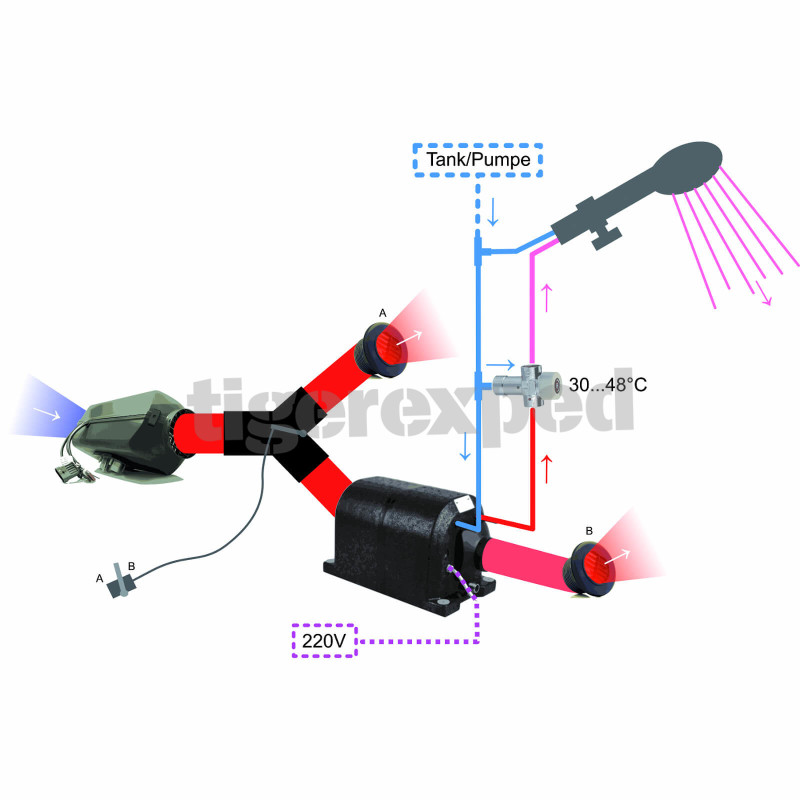

I don't know if i've made myself clearly. I do not mean a heater, especially popular in cold regions, that runs on the electricity network and heats the coolant (like DEFA, hotfrog, OWL and what they're all called). I also have one of these on board for winter travel. I mean an auxiliary air heater to heat the interior. For these, at least here in Europe, there are upgrade solutions for hot water production available. An additional water boiler is installed and when the auxiliary heater is running to warm the interior, hot water is also produced as a "waste product". Like this for example:

I never considered coupling a a hot water solution to one of those parked heater. Those heat up quite considerably, that would be an awesome addition to one
That's kind of what I had imagined. Those sorts of heaters are only now starting to get popular for some setups. I am jealous that there's a physical part you can order to adapt to it to heat your water. I did some searching for here in the states, I couldn't find anything
