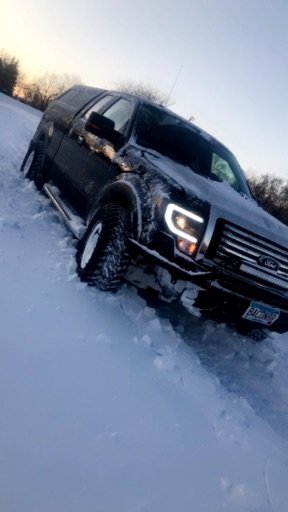

Hey there, just letting you know you can fit 33s without a lift if you prefer! I’m stock aside from 33x12.5r17 atturo MT with -12 offset. I do rub at full lock only when the suspension compresses.
& surprisingly my mud tires EAT snow & perform about the same as my old KO2s. Can’t get any good deep snow pics because I’m the photographer and driver.
I have a 2011 f150 xlt 5.0 with 3.55 gears and a rear lsd
