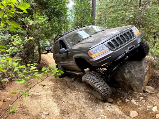

I have the Counterbalance beads in my WJ (metric 35"s). IMHO they work excellent, that thing is smooth all the way to 85-90 MPH (and probably past that, but that's the fastest I've pushed this thing, lol) other than one very specific speed around 20 MPH where some weird physics must be going on and they bunch up together and it gives the Jeep a "bounce." It's seriously only that very specific speed, and only a 1-2 MPH window. Other than that it's insanely smooth with no shake or shimmy or anything, which is pretty wild for what it is...

Dynamic balancing is the only way to go for large (35"+) mud terrain tires, typically results in less weight used and better results. That said I have never had any complaints with a shop doing a spin balance on A/T or highway tires. I do the air soft BBs trick when doing trailer tires because I'm cheap and do the mounting myself on the less critical equipment.
@tjZ06 that weird bouncing is probably due to the lower speed. In my experience the beads don't do anything until past 20mph, that's the point where there's enough centrifugal force to get them flung out and balancing effectively.
