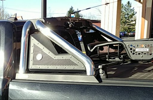

A pic of it with the spring kit installed, folded over on my truck. It essentially keeps the profile below the height of the XM antenna, which is perfect in my case.
I can add that the folding spring is a bit stiffer to work on the Comet than the Diamond. In my case, that was a consideration because I have the climb up the truck and reach other the center and try and fold it over with 1 hand. It's tricky, and I'm 6'4... :)

Looks good. Can you tell me if the antenna only folds over in one direction? I guess what I’m asking is when it’s folded over, can it rotate around the base or will it stay put?

It's essentially a rotating hinge that has a spring to keep both ends from slipping apart if that makes sense.
It will only fold over one way, but it will sweep like a turret.
On my truck, I always fold it over the bed of the truck. It can and does 'drift' slightly to the left or right at times (which drives my OCD crazy), but it has never become a propeller or slapped around.
Best analogy I can provide is think of a flexible straw in a cup with a lid. Imagine the straw only flexed in one direction, but could still rotate in the straw hole of the lid on the cup.

That’s good to know, in my application I was planning to fold it over to the side, but from what you have told me it will weathervane. I will need to rethink my plan.
I had considered making a small teether line to hold it in place using a slipknot, but have never found it necessary with it aimed towards the back.
In your setup, I could see it drifting towards the driver behind you and possibly getting snagged and broken off.
They are not that big, so you may be able to just remove it when not needed and slip it behind or under a seat etc...
