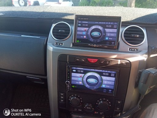

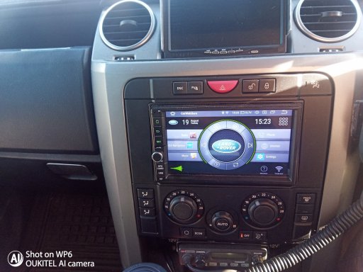

Plenty of the android based head units use real GPS data for navigation, i have a 7" Eonon head unit with external GPS antenna that works well.
2nd screen is connected to the output of the head unit and has 2 inputs so i have a front mounted camera as well, it will run any compatible android navigation app.
