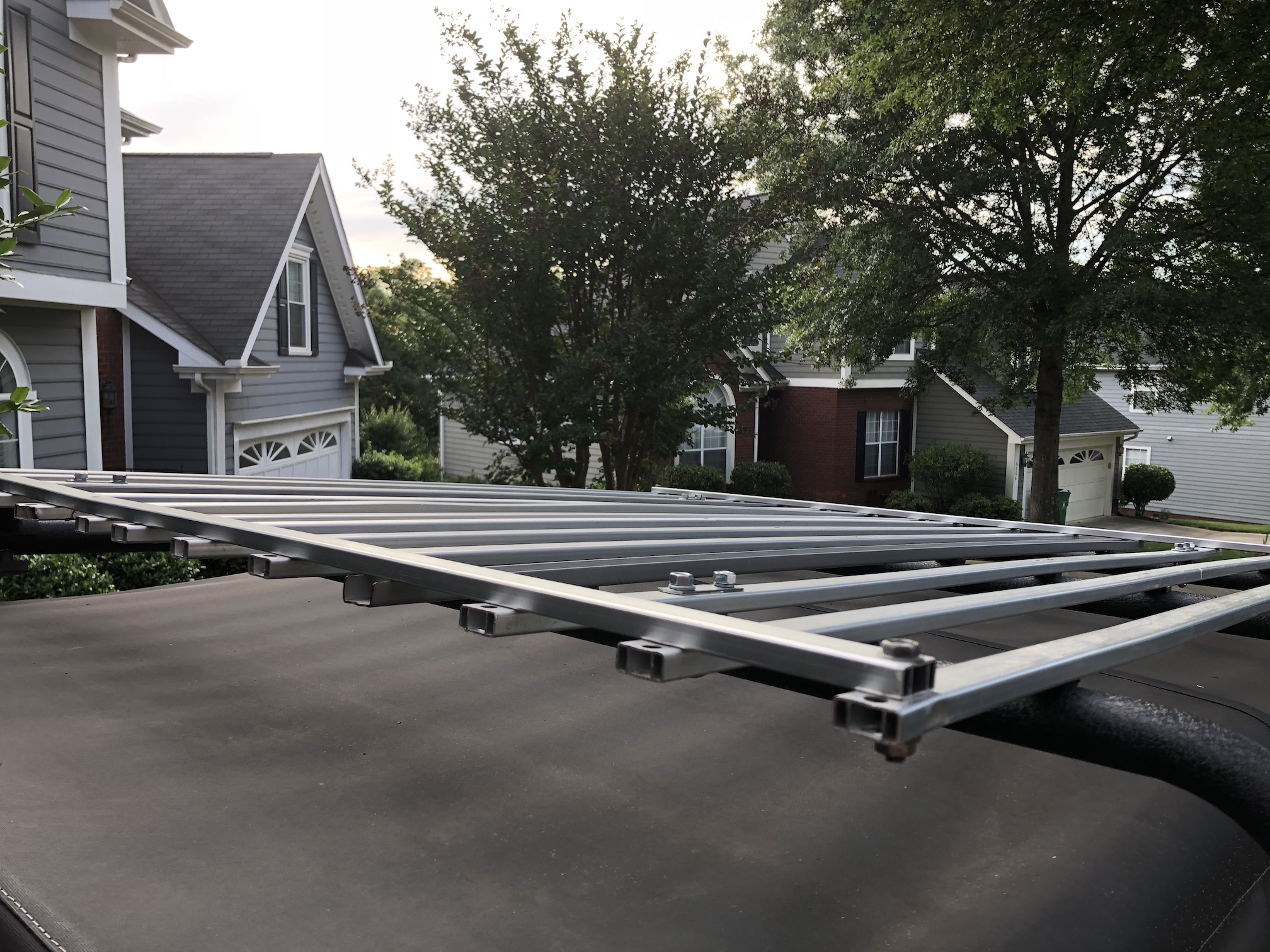

Not sure why, but I can't see any of your photo attachments. Regardless, check your area for metal scrap yards. I'm always amazed at the types of resources available when I visit the one near me. Here's some photos of a platform I made for my jeep from aluminum pieces I got for under $15. I capped the ends recently, but haven't taken a photo. This works great, and while not quite as slick the frontrunner I've been pretty happy.
