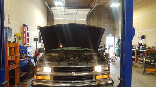

20180405_165543.jpg 20180405_165605.jpg 20180405_193357.jpg 20180404_221924.jpg After parking my K5 and going into a 98 Forested S I'm now jumping into a 98 Chevy Tahoe that's been my daily for 2 years now. Doing everything as low cost as possible. Starting with my headlight mod. For as long as I've been around GM has it set up that when your high beams are on your low beams are off, leaving a dead spot in front of your truck. With a fuse block I pulled from a old project and a relay w/ pigtail from the auto parts store ($26) I now have quad high beams.

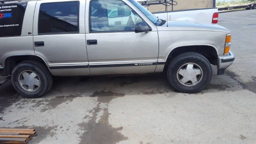

Not the project I wanted to do, ( I was going to build my rear storage ) but it needed to be done. Went from 245/75R16's to 265/75R16's with wheels I found online for $160. More ground clearance and looking better. The the 20 year old radiator started leaking engine oil, and the 20 year old windshield wipers motor went out in the rain. I replaced the wiper transmission with the motor, it is also 20 years old and had a lot of play in it.20180522_191817.jpg20180522_191808.jpg20180518_131800.jpg

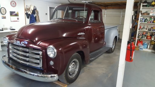

So I built the roof rack and we did get out 2 more times, I'll be posting more on that. It was a crazy summer and a lot of fun, starting with the 53 GMC I picked up and have been restoring with my grandpa.
