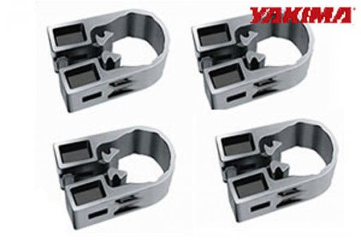

I just use standard Yakima round bar clamps. I built my rack with 1.125” tubing so all Yakima stuff would be compatible. The bolts can however be challenging to line up solo.

I know this is old, but just in case you are monitoring this posting, I have a question. I am looking for options to mount my RTT on my Yakima system with round bars. It never occurred to me to use the round bar clamps. If I understand what you did correctly, you only have one bolt on each corner? Do you know the rating of those clamps? My RTT is a Tepui Gran Savannah and the weight is about 150 pounds. If you have any pics, it would be great and appreciated. Thanks!

I just sold my tent last week but it was a Ruggedized autana. Near 200lbs. It was up there for 3 years never moved, wheeled HARD. No idea on the Yakima rating but I wound not hesitate to do it again. And yes 4 bolts total.
