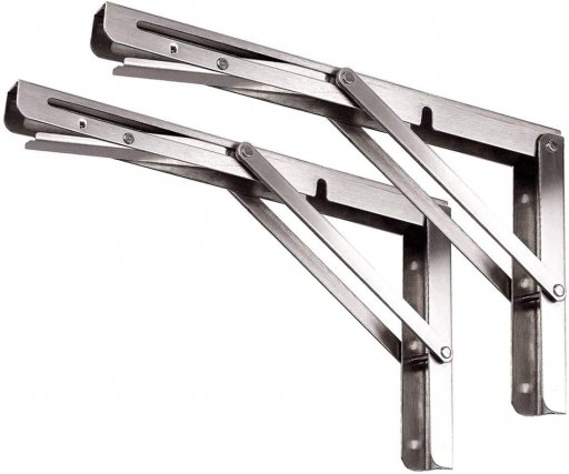

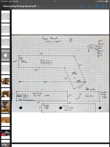

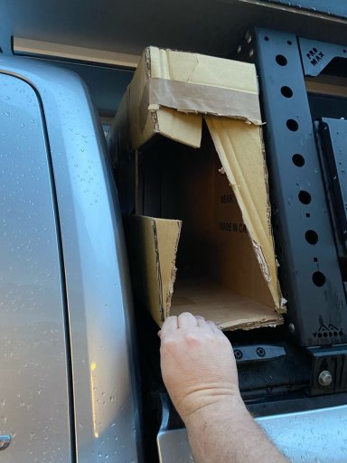

Did a rough install of the mounts with awning. It was challenging to get the mounts paralell, level, and the awning mount holes drilled level. I still need to finish the locking mechanism and the set screws are in. Once I finalize everything I will paint them.
They are so strong I can hang my body weight off of each mount alone. Stowed the awning is 1/2” away from the tent and then it extends 4” out to allow the tent to open. It is tucked close which I am happy about.

Finished! Primed, painted, and mounted. And surprisingly….they actually work great!
They slide out 4” to allow the iKamper to open to the side. They are each strong enough to hold my body weight. They have a push button release, a safety bolt so they can’t come apart, and set screws to make sure it doesn’t rattle on the trail.
