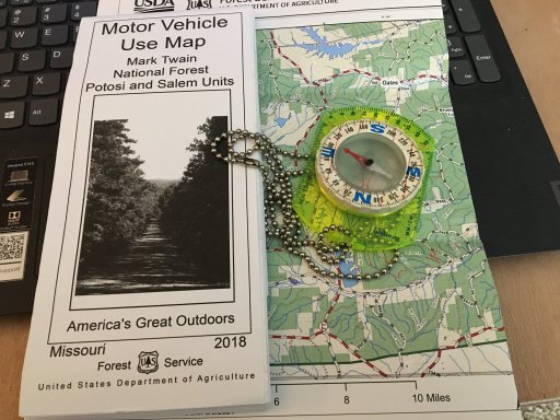

I drew maps for a living and surveyed as well, so paper maps are sort of my thing. I'm not sure now days I could put a price on my safety in the back country tho. Having multiple layers of navigation resources would be the prudent thing for me.
In the very bottom pocket of my seat back is a compass I've had for a long time. I can orient with the best of them but a map is handy to do so. LOL
Zim
Anyone that goes into the back country without a compass is... I'll let you fill in the blank there -- any retired Sailor knows plenty of descriptive terms to use!
