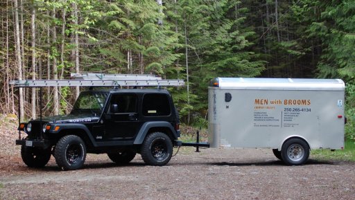

I too tow a trailer, but I do it for work, daily. On 33s with 4.10s,
I know how to shift. I've got a million miles with an 18speed. I would love to regear to 3.73s.
2000# plus ladders, 12K miles a year towing, 24K miles a year on the TJR.
In the mountains. It is my daily driver plus my work truck.

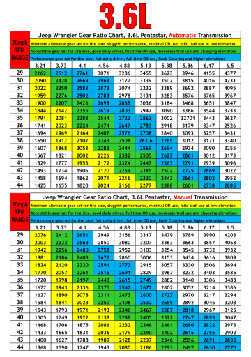

@Cendee also just re-geared with 5:13's, she has the 3.6l engine.

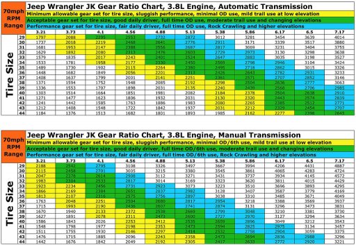

2011 he has is the 3.8l mini van engine check out the other chart

So, I can't tell you much about your regear question, but there's a lot said and the gear ratio chart should answer all questions.
