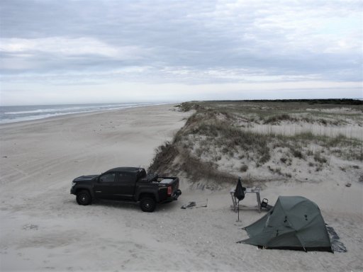

My wife does join me; probably wouldn't be doing this otherwise. I'm on the north side of seventy so age and physical abilities certainly played a part in our decisions. It sounds like your style is / will be similar to ours - boondocking and dry camping on remote public lands that don't require hard core access and having a vehicle built well enough to get you out should you overextend things a bit. We've always enjoyed setting up a base camp where we'd stay for multiple days and then use the truck to explore backroads and attractions in the surrounding areas. We soon found that shells, truck campers, rtt's etc. just wouldn't work for us in that scenario and chose small quality ground tents for sleeping along with a separate good screen room for cooking, weather and kicking back. Twenty years or so back, we added a small molded fiberglass camper (19' Scamp) and that's worked out well. Its primarily for sleeping, bathing, the head and additional storage for clothes and gear but it has AC, heat, hot water heater, fridge etc. and we carry a genset along so have all the comforts of hookups if desired. We still take a ground tent and often spend a night or two on the trail away from our base. Point being - your choice of accommodations will impact many of your vehicle options.
I've turned my share of wrenches in the past but that no longer holds any interest and now prefer to get a truck that meets as many of my needs as possible directly from the dealer. However, those needs are structural and performance based not cosmetic and/or snake oil - ie. 4WD, lockers and skids are a must but not window vents or paint protection. Other 'performance' options that have no appeal to me are cold air intake, auxiliary lighting, modified exhaust, enhanced electronics for nav and music (although extra USB ports are very nice), jacked up aftermarket suspension to accommodate huge tires and bed mounted spare tire. Could be me just getting cautious but I don't want anything that grossly changes the mission of the truck as developed by the mfr.
We have a 4WD Silverado extended cab long bed on the farm so I'm well aware of the difference between midsize and full size - midsize is just a better fit for us when camping and exploring. I came from two Tacoma TRD Off-Roads (05 & 12) that were great trucks but felt underpowered with the current engine offering and now have a 19 ZR2 gasser with the Bison package. It has the Chevy offered dealer installed 9.5 RS ComeUp winch (Awesome and quality as good as the Warn on my TJ) and the premium sound/nav as the only other options (really had no choice on the electronics as I bought off the lot). Very comfortable truck for long (500+) towing miles per day, the DSSV shocks just absorb everything on and off-road, mileage is 16 towing / 22 over road, adequate power, lockers front and rear, full skids, bumpers with recovery points, large gas tank, smooth eight speed tranny (none of the problems reported by many others), heated steering wheel and seats (good for old bones). I really can't think of anything in the option list for this truck that I'd omit, If you're into mods, there's still plenty to be done - replaced the side skids with frame mounted units for better protection and bed access, added a 110V inverter (Chevy really dropped the ball on not having this), GMRS comm, bed mounted tool box, recovery gear, better reverse lighting, rear shock skids, bed tie downs, on board air, Bed Rug (love it), bed mounted 12V Anderson connector, MFC and MWC holders, fifth wheel hitch for the camper. About the only other big upgrade still being considered is a Rhino Rack roof rack for additional storage when pulling the camper. FTR, Toyota does have much better interior storage than the Colorado. Good luck and hope to see you on the road some day.

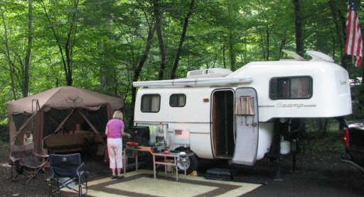

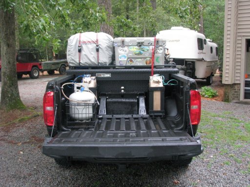

Sorry. Did you just say that you 5th wheel tow with a Chevy Colorado Bison??
huachuca
1,421
tarboro nc
Al
Killebrew
24080
Well....sorta....kinda. Its not a true fifth wheel but it does use a hybrid bed mounted hitch. The rails, legs and cross member are standard of the shelf Reese Hitch parts but Scamp adds a flat plate with a ball to the truck end and the trailer has a conventional bumper pull coupler welded to a 'neck' that extends over the tailgate. Sounds a bit hinky but I have better than twelve years and over 150K miles dragging it around the country - first by a couple of TRD Offroad Tacomas and now the Bison. The trailer comes in around 3,500#s with all our gear aboard, pulls like a dream and the Colorado get between16 & 17 towing if I keep the speed around 60. There's a link in my previous post to the Scamp site with more info on the camper.
Huh. Wow. I was about to ask, at 3500lbs, is it worth all that extra equipment and effort just to tow with a 5th, but it seems it's less a matter of weight than it is the fact you get that overhang to sleep in. Lot of extra space.

Thanks, I'm sure we don't qualify as true 'overlanders' and I'm good with that. You're right - lots of extra space plus a hot shower whenever we want, flush john for Mama, A/C if its really hot (or furnace if cold), comfortable mattress, good sized fridge with freezer, and small enough to fit down most primary USFS or BLM roads when looking for a campsite. Home is (and always will be) NC but we love travelling, camping and exploring all across the US and especially in the southwest. We also like having the grand kid along with us whenever possible and this setup makes all of that feasible with minimal effort. Although most of our camping nights are now in the Scamp, we have room for our tent, bags and pads and usually take them along 'just in case'
View attachment 207398.
Sounds like what I'd want. I didnt know they made Scamp anymore, let alone with a "mamma's attic". That's great!
