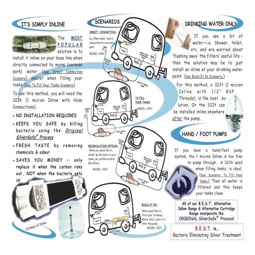

Not sure if the original poster is still following this topic.
But we find inline water filters work great as long as you are using a tap which is running of a mains.
Gravity fed taps don't have enough pressure to work well with these.
We connect our hose to the tap with a filter within this hose and fill our tank up this way (scenario 2 in the drawing). Works well.
Otis Porsche
Thanks, this is a solution that will work well in car parks which we have used. Most of our travels are at dispersed sites off grid near streams & lakes. Will probably have to hand pump & filter into our 20l Scepter can from which pour into our main tank.
I didn't realise this. Guess we are lucky in Australia as every town and every petrol station will have a water point, most of them are free to use.
