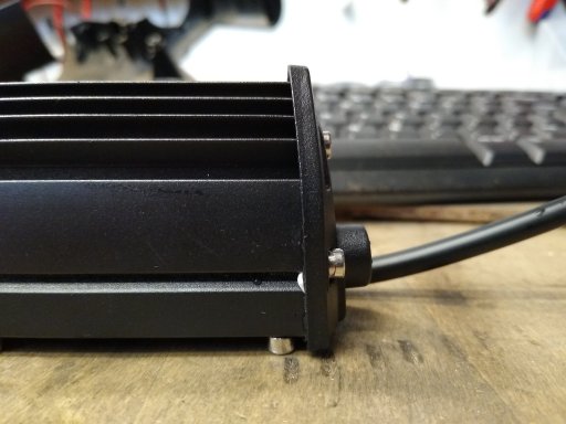

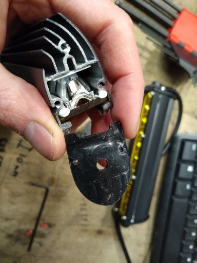

Build quality... Well what can you expect... Cheap stuff from china. The side covers were a bit crooked. Took the side covers off and found a problem..
The white gasket material that seals the yellow lens sticks out at the sides. Which gives problems with the side gasket and cover.
Cut off the excessive white gasket material to make it flush. This fixed the crooked side covers and hopefully any leakages.

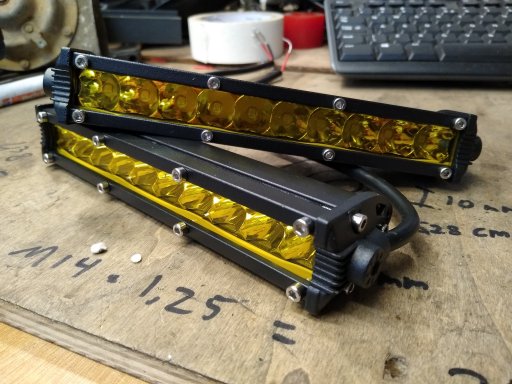

But was impressed by the thick plastic lens. Expected it would be a flimsy.
View attachment 187471View attachment 187472View attachment 187473

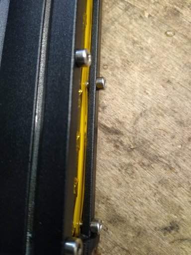

And the way the lens is mounted is a bit dodgy. Allen key bolts just screwed against the lens and is totally crooked as well.
Well what can I say. I guess these lights will have problems in the future due moisture because of the bad build quality. But if you will take some time you probably can make them a little bit better like I did.
