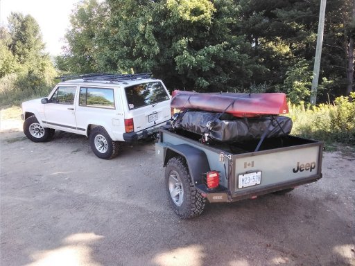

Not quite the same situation but I have an RTT on my trailer and sometimes carry my kayak on top of it. It's a pretty basic tent that I'll just describe as "soft".
I strap soft roof rack pads (link below) to the tent and then the kayak to the pads. They strap down firmly and I've had no issues.

Nice setup! Thanks for sharing, I was wondering about whether I could some soft padding and then strap it to the top of a normal RTT. Although, I do like the fact I can use the RTT without removing the cargo on the RTTs with built-in cargo bars.
