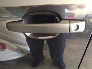

After that I realized I didn't like all the chrome on my vehicle so I started working on covering it up and making it look to my liking.
I plastidiped my grill and had my door handles covered in flat black vinyl as well as de badged my trunk.

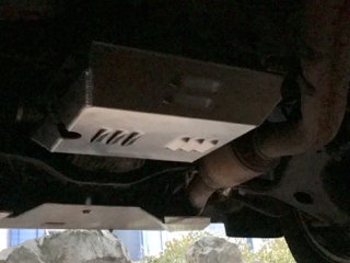

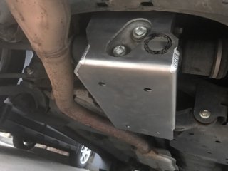

From here I was done cosmetically for the time being and started thinking about making it a more capable rig for off roading here in the NW, my first purchase was a set of Triple Armor from Primitive Racing.
With a front Sump, trans and rear diff skid plate installed I was happy I wasn't going to push a rock threw one of my low laying pans or diff. But started to think about a lift and larger tires now.

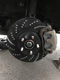

So those went into storage as I waited for the lift kit to be fabricated and as I was thinking about the coming upgrades I figured brakes would be a good upgrade as well. So I researched what I could and came up with a set of slotted and dimpled rotors and a carbon ceramic break pad.

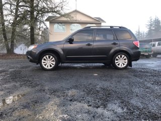

After I had upgraded my brakes I waited for my chance to get into ADF's shop and get my lift kit installed.
It was a very long few months as I waited for my lift to be fabricated and get the chance to finally show up but that day came and I couldn't be happier with there service and support with this lift kit and build!
I brought my new wheels and tires with me when I went to get my lift kit installed so when we where done it was a complete package!
Here is an after/before picture.
ADF thought out and fabricated allot to get this Kit top notch for this vehicle, even some nifty logos on the strut tops!
After all was said and done it turned out to be the 3rd 09-13 Subaru Forester in the states that I know of to be on a 4" lift.

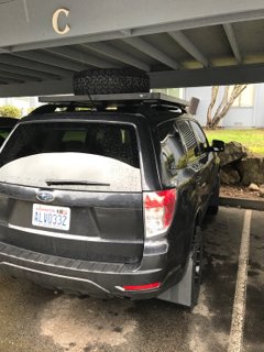

I wanted to start Outfitting my Forester now for cargo and gear I already had to get ready for the upcoming trips to see family in Idaho and Montana so I ordered a Frontrunner roof rack and spare tire mount.
After a fair amount of adjustments and getting it all set up it's turned out to be an awesome upgrade only weighing 67lbs and able to hold a 660lb static load.
