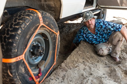

Dear Sirs,
We are an Australia manufacturer specialising in offroad recovery gear with a new and innovative product and technique that offers foward and reverse recovery.
BOG OUT is a rope harness that is attached to the bogged or spinning wheel, the other end is secured and then you simply drive out. Two BOG OUTs secured on either the front or the rear wheels provides highly effective, twin diff lockers and the system will work on any vehicle up to a small tractor. It has been tried and tested in Australia for over 5 years.
We have many happy customers who already have a winch but like our product as a back up for when they need to reverse. Other customers have SUVs and cannot fit the bull bar to mount the winch. The system is lightweight, compact, safe and reliable. Please see BOG OUT 4x4 Vehicle Recovery System |Turns bogged wheels into winches
We are seeking USA based influencers or youtubers to review our product - we have Central Queensland University testing, 4WD club and customer reviews - all Australian and would be honoured to have opinion from Overland Bound. Please note, we are a small family owned business - our product is made in Australia and we hope to launch in the US via Amazon shortly.
Please advise how we could support Overland Bound.
Thank you for your kind consideration

Does anyone have questions? This is not just a new product, but a new technique. It's simple to use but sometimes we find there are lots of questions.We've worked with some of the 4WD Clubs in Australia - eg Western Australia 4WD Club independently: .
BOG OUT is now online at Amazon's USA Warehouse. We've put aside some launch discounts for Overland Bound Members so please PM if you're interested in purchasing a Twin Pack and want to save 20%. Click to Link to Amazon

By no means is this technique new its called bush winching it been around 40+ years. You dont even need to buy anything but synthetic rope to do this. It works but by no means is it easy or the prefered way this technique should be used only after everything else has failed. It aint fun trying to untie a birds nest wrapped around your hubs,brakes and control arm in mud because you cant turn when using this method without rope slipping to one side or the other. This method is also best employed on flat ground ie stuck in sand on a beach in a straight pull not on a hill or a deep mud bog or side pulling.
On this bush craft note ill add you also dont need a hilift jack if you have metal bumpers just cut a log around 5 inches taller than your bumper wedge it between the bumper and ground the drive forward the log will pivot and lift your front or rear.

Hi Boostpowered
You're correct in saying that using a vehicles wheels as massive (and free) engine powered winches has been around for some time and the US Military Recovery Manual you identify is a great practical reference, using physics and bush craft. The Australian Military has some similar documents, probably hard learned shoulder to shoulder.
You might remember the old Landcruisers too with the extra hub on the front wheels, aluminium with heavy knurling. They were designed as a step to get up onto the bonnet to get the spare tire off, but were also used for winching. This system works, as does the rope between dual tires method shown in the manual, good in an emergency as you say, when all else fails. But neither work well because the binding up or slipping off problem with the dual or single wheel system, and the increased mechanical advantage and wider than designed for axle loads applied by the use of the hub system.
Don't be silly enough to try using a rope or strap to sit on your tread. It might work a bit on dry sand but will just slip off and cause the issues you describe, definitely best avoided.
The patented BOG OUT technique overcomes these issues by positively capturing the tire, so all loads are directed exactly where the vehicle is designed to be loaded, the bottom of the tire tread. This provides the most efficient tow point possible and therefore reduces loads significantly as it assists the vehicle upwards, out of the bog or over the obstruction unlike other winch, snatch or tow recoveries that tow from the chassis height, usually pulling the vehicle downwards, increasing loads.
The BOG OUT System has been torture tested thoroughly in Australia for 5 years with NO breakages and NO injuries and are recommended by 4x4 Clubs and purchased by Government Departments which do remote work. There are easy methods to get them off your tire once the recovery is complete, have a look at this video How to Remove BOG OUT.

Aside from the caution that should be used if your running this on the front of an ifs vehicle, id recommend using the rear wheels to save your cv joints and half shafts. On solid axle no worries.
I would like to know what methods yall are using for land anchors in the sand, are you hooking up to another vehicle? Using a deadman with spare tire? Rebar spikes?

Hi @Boostpowered
You're right, the anchor point should be in a reasonably straight line to the wheel. There's approximately 15 degrees leeway either side. It's a modular system so you can attach low stretch extension rope if its more convenient to anchor further away.
Using the BOG OUT does not apply any more stress or strain to your vehicle. The harness is merely giving the wheels the traction that they need to get your vehicle going again. Here's an independent article written in Caravan World Rescue Remedy - Scott Heiman
BOG OUT is a steady recovery method that is used slowly. It's easy to stop, check and adjust if necessary.
Like a winch, an anchor point is needed and if there are no handy trees then it can be another vehicle, buried tyre, star pickets & chain. NB during recovery BOG OUT uses considerably less load than higher mounted winches. The angle of recovery is highly efficient so you can get away with smaller, lighter anchor points.
Thanks for all your questions which we are more than happy to answer.

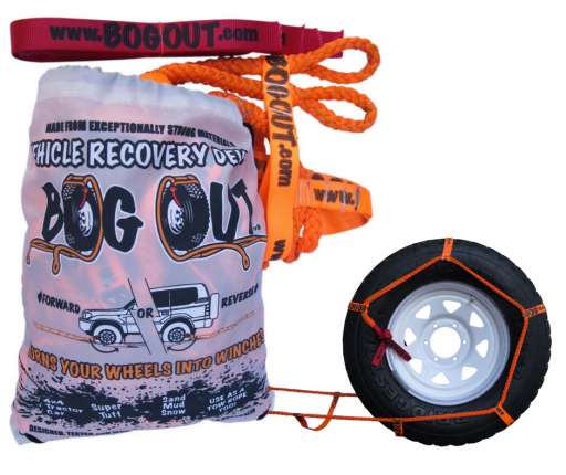

Introducing a new and innovative product– this is a new technique that offers forward and reverse vehicle recovery and works on all 4x4 vehicles.
Invented and first tested in North Queensland under harsh conditions over 15 years ago, BOG OUT has been on the market in Australia for over 5 years and our family business manufactures locally near Cairns, North Queensland.
BOG OUT is available in the America for the first time and we’d like your feedback.
How does BOG OUT Work?
BOG OUT is a rope harness -
1. Attach one end to the bogged or spinning wheel,
2. Next, secure the other end to an anchor point, then
3. Slowly drive out
Tried and tested in Australia for over 5 years - it will fit any 4x4 wheel and works well in ruts, mud, sand etc.
Maybe you already have a winch but would like a quick and easy solution for when you need to reverse.
Alternately, your vehicle's bull bar isn't strong enough to mount the winch. Or, you just want peace of mind to because when you go off road there may not be another vehicle to help you out.….
BOG OUT is a safe, reliable and economical tool. Fits in glovebox or under the seat. Handy when its needed. It will double up as a tow rope too. The Twin pack is
Twin Pack Vehicle Recovery Kit Stats: Each backsack contains 2 x BOG OUTs, plus 4 red connector ties and full instructions.
Each BOG OUT is 14.7 feet long (4.5m) and a break strain of 4.8 Tons. Use the Twin pack and you have 9.6 Ton break strain which is 2 or 3 times the actual load used during recovery.
Twin Pack weighs 4.85 pounds.
BOG OUT is lightweight, compact, safe and reliable.
We'd love to know your thoughts and answer your queries. BOG OUT Twin Pack has just gone on sale on Amazon - Link to Amazon
