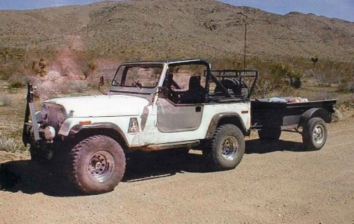

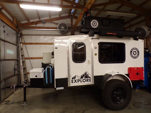

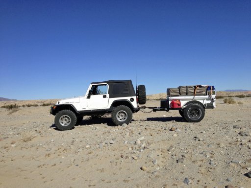

Before I added an RTT then built a tear drop. My M-100's went everywhere. My issue was similar. Different Jeeps and no room for 4 people and a week of gear. Alone I could live out of a back pack but the rest of the family needed more. I want to say I used those trailer's from late 80's to 2015? ish?
I don't have many earlier pics but here's my first one before I started moding it and the last one before I retired it. The last one got a bigger axle with brakes, don't remember when that was.
Edit. I added the last one to show the RTT didn't mount high. Its actually on a lid. You could build a short frame, mount to that and still reach under as well as tailgate. Trying to simplify the build if you don't stay with a ground tent. I kept a low center of gravity because it went down hardcore trails.

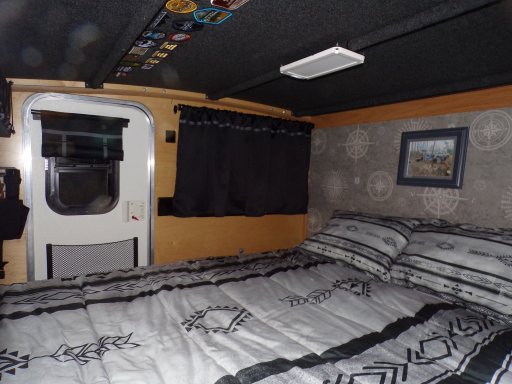

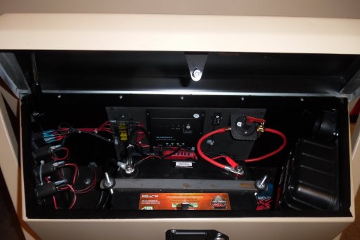

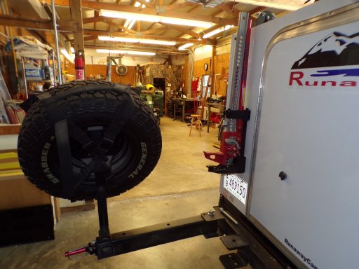

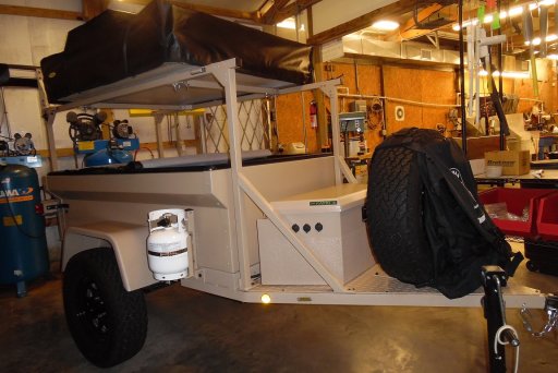

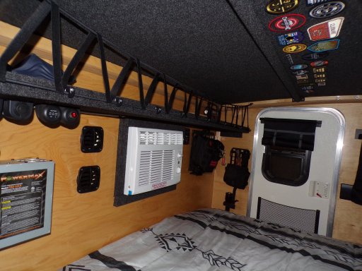

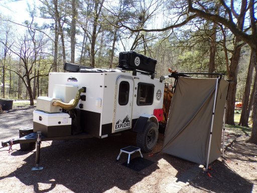

I done two trailers, the 1st is a entire build with Dinnot Tube, the 2nd was a new 2019 Runaway Range Runner which was taken part & gone through a major transformation. Both I budgeted both went over the budget. The 1st took 10 1\2 months from start to finish, the other was 5 plus years with using the trailer along the entire modifications. No matter how you look @ it, nice part building your trailer is fitting it to you & your wants & needs are. The 1st trailer I used a Harbor Freight frame that I modified building new tongue, reinforced the chassis, ran shock absorber's. The wife & I used this trailer until she couldn't climb the ladder any more. When I sold this trailer I had 3 people having a bid war over it, I sold it far more what I originally was asking (keep that in mind) it was a quality build. My 2nd trailer I shot over the budget mark "big time", I've own this trailer for 5 plus years & recently had a offer for 20,000.00 for it. I built this trailer around what I & the wife wanted & needed "for us." I did turn them down. Again it's a quality build & if you keep in mind "resale" value & keep a build log with list of the parts you'll be surprised how that only enhances the sale of it when the time comes. This summer I will be installing electric brakes which is the last of the add-on's. You don't have to finish the trailer in one shot, this way you can use it & still make decisions on what gear & items to install.
View attachment 279315View attachment 279316View attachment 279317View attachment 279318View attachment 279319View attachment 279320View attachment 279321View attachment 279322View attachment 279323View attachment 279324View attachment 279325
those are some outstanding builds.
