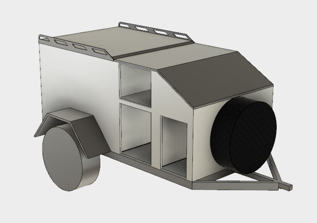

The initial design that I drew up in an hour or two after driving home from BC Overland Rally -
At this point I had decided that I wanted the trailer big enough to have some misc. storage upfront, and a couple slide outs for fridge/freezer, stove, etc.
This design hasn't changed much, mainly just slight dimension tweaks to allow 4 RTT's to fit in the back, as well as some slight rearrangement of the front doors.

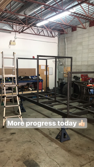

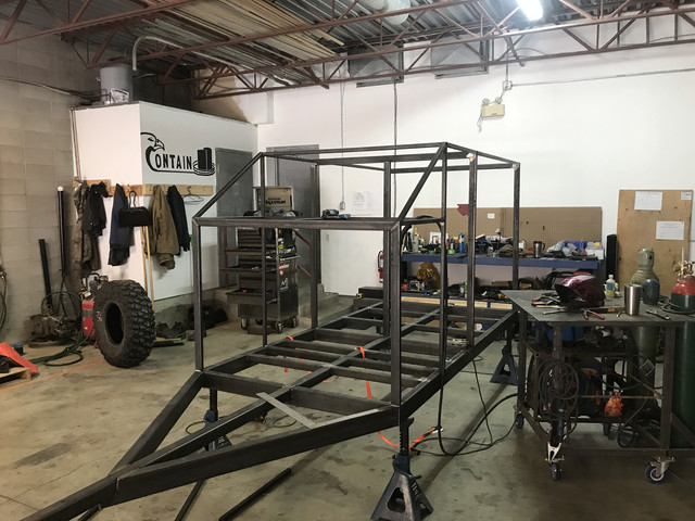

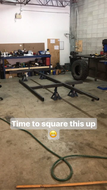

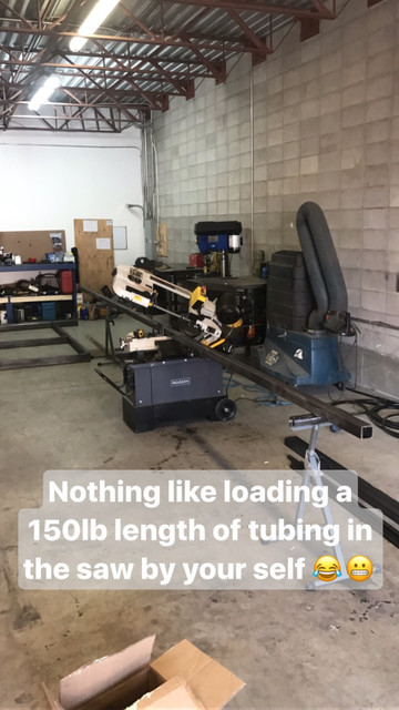

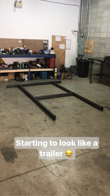

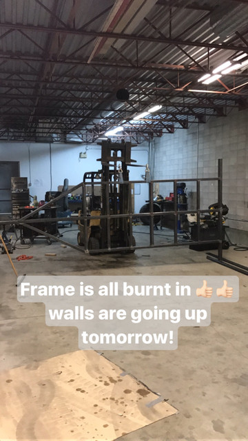

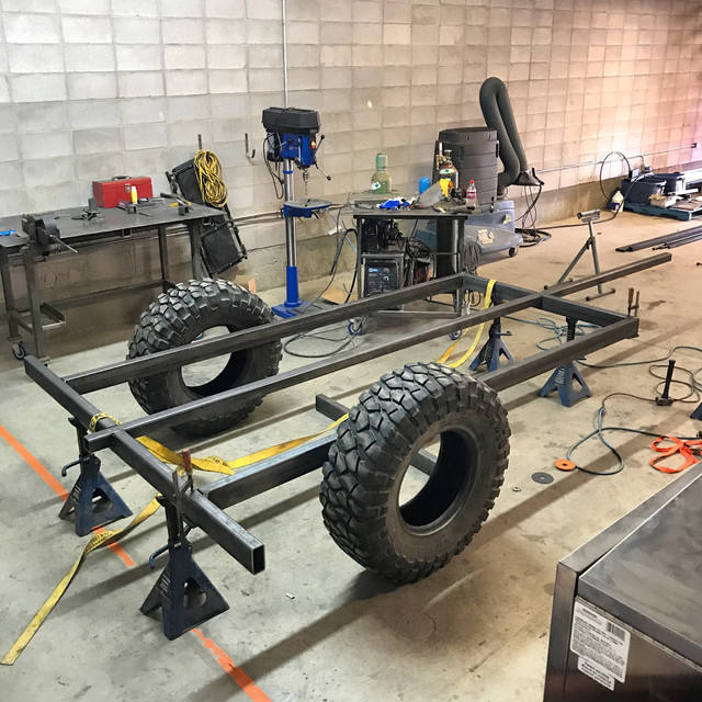

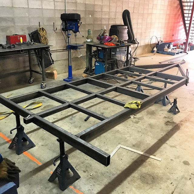

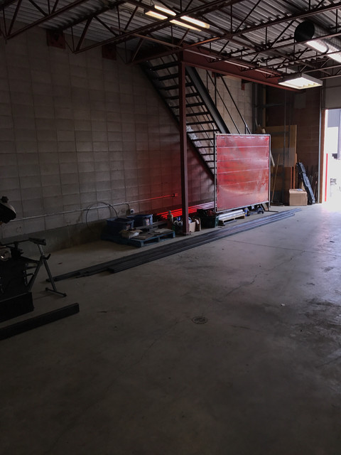

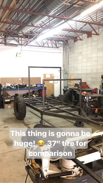

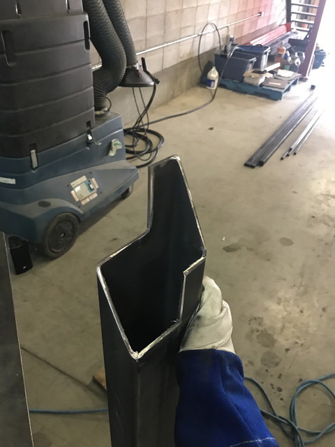

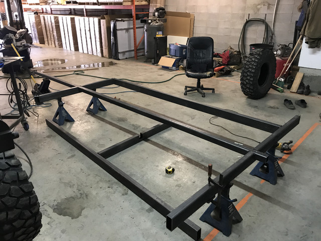

I had all the steel delivered last friday, and immediately put the bandsaw to work

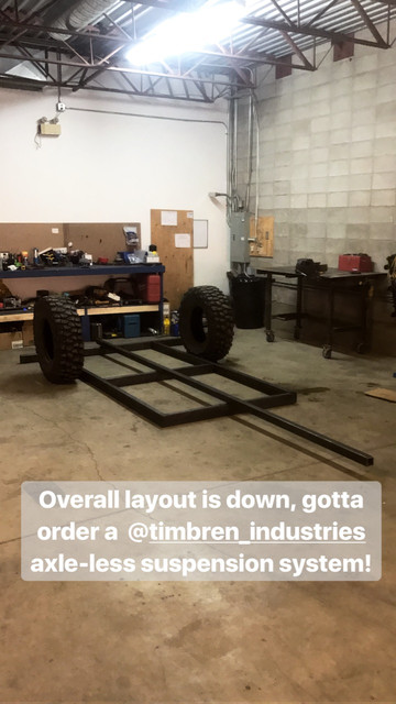

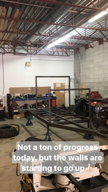

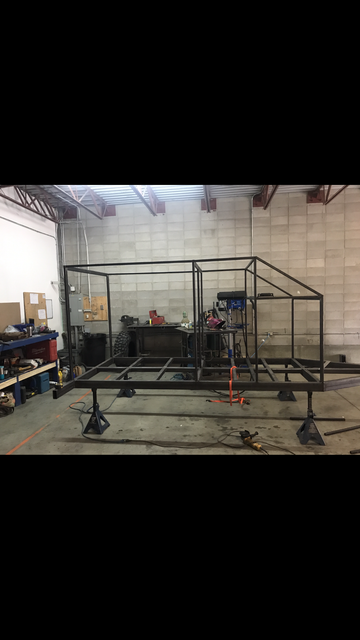

This is basically how the trailer sits right now. Since the photos i have finished bracing all the walls and currently I am waiting on the suspension to show up so I can finish the side steps and get this thing painted and skinned.
Timbren suspension is supposed to be here tomorrow!

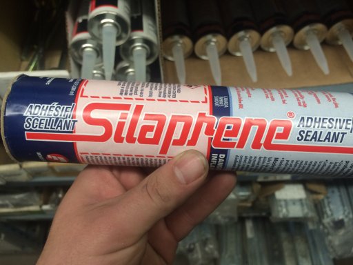

image.jpg Also, this is the product we use with aluminum when we need adhesion and a sealent. Id also recommend using 1/4" stainless steel "huck" rivets instead of aluminum. Make sure you use sealent on every rivit hole to avoid leaks. Especially if you're traveling around British Columbia!! Hope it helps!

View attachment 29931 Also, this is the product we use with aluminum when we need adhesion and a sealent. Id also recommend using 1/4" stainless steel "huck" rivets instead of aluminum. Make sure you use sealent on every rivit hole to avoid leaks. Especially if you're traveling around British Columbia!! Hope it helps!
I was actually leaning towards using VHB tape with a strategically placed row of rivets down each panel. Any Concerns with that?
Johnnie Canuck
Never actually used it myself. But I know the applications it can be used for are demanding. And if u use a caulking gun like i do, then it should be alot cleaner!
