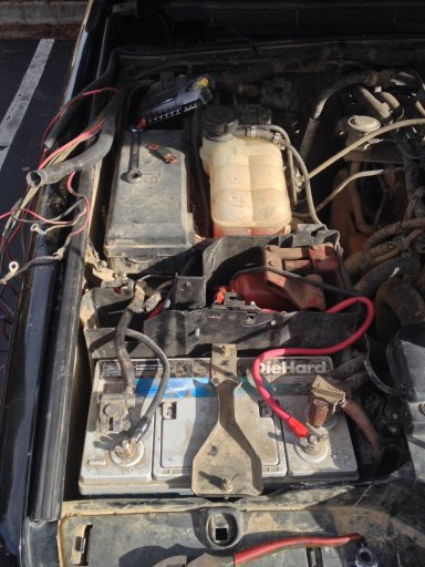

Ok, I didn't want to derail the dual battery thread so I figured I'd make a new post here.
All of this was connected to my main battery!
A 150A MEGA fuse is bolted in front of the red bottle jack. It's kinda hard to see, but the bolts for the holder are just above the battery.

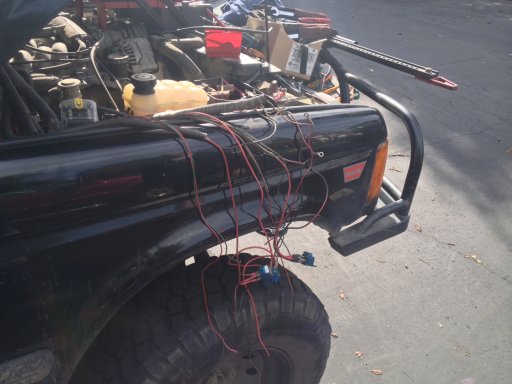

My buddy made the bracket to hold the fuse block and relays. It's about the only space available.
