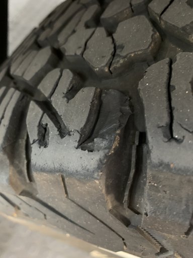

Hi Folks,
I would like some feedback from BFGoodrich KO2 owners, especially in the US, on their experience with these tires please.
Mine are just under 2 years old and I've only done 17,639 mi on them. I rotate, balance and do wheel alignment at least every 6k mi. I run 36 psi on tarmac, 29 psi on gravel roads and 21 psi on rough stuff and thick sand (BFG have confirmed that this particular tire should be run at higher pressures). Most of my driving is still on tarmac (70%) and the rest gravel (20%) and maybe 10% rough stuff. No snow here :wink:. The current tread is around 7,4 mm (12.7mm new) but I have a lot of tearing in the tread. I literally have chunks coming out the tread blocks. BFG reckon this tearing is normal because this is an all-weather tire. Based on their estimation I will only get around 30k mi total on these. KO2's sold locally are manufactured in Thailand, not the US, hence my curiosity if there is maybe a difference in quality? KO2's cost around $287 a tire locally for a 265/65R17 (30.6") excl. fitment.

Oh, I'm also very curious about the answers. I had exactly this experience with BFG MT KM2 some time ago. I have driven many sets of the BFG MT and then a similar picture on a trip of several months. Massive damage with broken profile and this happened with not even extreme stress. Never had these problems before and then I met on the trip someone with the same problem. So maybe there really are different qualities? I have then changed to Toyo Open Country MTs as they were available where I was at that time. I now have the second set, soon comes the third. The Toyo is good for about 80k kms at my driving profile.

Not normal at all. I used to run BFG K0 tires. Easily get 50,000 miles out of a set of 4, legally sell them used and the new owner would get another 10-15k miles out of them. Like you, our tires are used on about 70% pavement; 20% gravel or dirt and 10% rocky technical rough stuff. I also have always run E rated 285s at 36-38lbs of air to support our 80 series scaling out at 7,000 lbs loaded. I might have seen one or two very minor chunk outs on two sets. About 10 years ago my tire guy did ask- you want the good ones, right?- as he said, there are two grades of these tires. Of course, I got the good ones. ( made in USA ) I’m saddened to hear of your negative experience with BFG. I switched to General tires two sets ago only because of cost considerations. The Generals are every bit as good as the BFG, just a bit softer sidewall.. good luck !!

I can't really say that I've experienced a deterioration in ride quality but I would think having chunks out of your tread means reduced surface contact surely.

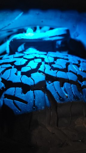

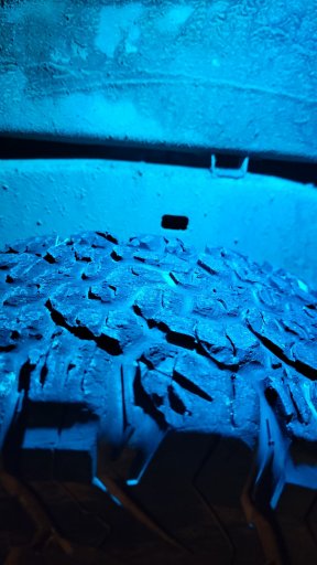

This is my tire after only a year if you drive it hard the rubber will chunk off this happens when you drift or go high speeds off road this is my front compared to my rear tires
Spoken to lots of folks subsequently, seems if you have the US-made ones and drive at the correct pressures they're still fine but the Thailand ones; doesn't matter what you do, if you use them off-road you'll be lucky to get 24k mi out of them.
I've moved over to Maxxis Razr AT-811's and haven't looked back;
