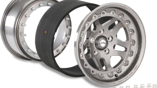

I run the Hutchinson two piece wheels, that provides an inner and outer beedlock. I also use runflats: after bandits put boards with nails, across a road in Mexico. I had two flat steer tires, and had to pull over. With my current setup, I would have kept driving.

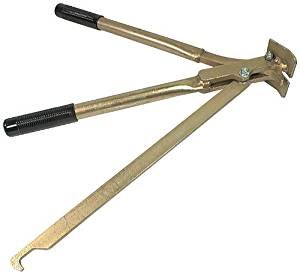

This has also been my experience. I have two piece rims, that make it very easy to change out tires. This is one of the reasons many military vehicles, and NGO use them in extreme terrain. I carry a tool to help separate the two piece wheels.
This allow me carry a spare tire, in addition to my spare tire/wheel. I have been in situations, that I has multiple flats, that could not be fixed with a tire repair kit (Long sidewall slashes). The second spare tire allowed me to keep on my journey.
