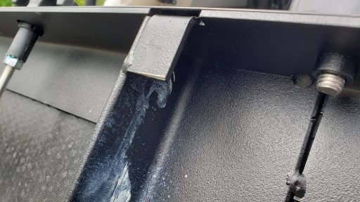

2) I noticed under the bedslide itself, that this tab (which when fully in, I assume is there to keep the back end from lifiting up and off the frame when hitting bumps etc) there was slight marring of the edge that was not on the other side.
As well as the "lip" on the underneath of that replaced roller... I ended up taking a file and (I sure hope I'm not voiding any warranty, as I am trying to get this to work as intended) I filed down a bit of that lip, and less than a little bit of the tab on the underneath of the deck, and voila! It now slides in and locks without having to lift it up a bit... I'm not going to call this as the sucessful fix, until I have more miles with it, but it seems like either in the welding process things were not quite as square, or the tab on the underneath of the deck was not cut quite straight enough to clear the frame.
I'm sharing the findings with Bedslide as well...
