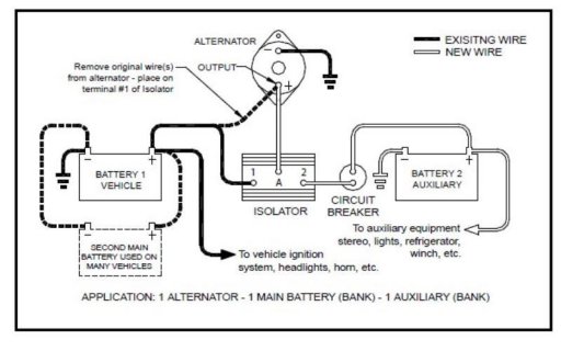

I use this quite a bit in my work when trying to describe a vehicle secondary battery and inverter install. The diagram as a VERY basic concept. You can get as complex as you desire...however, remember Simple is usually better.
