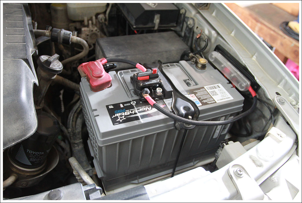

Like MidOH I prefer to run a single wire from the positive terminal to a separate fuse block or buss bar. This way I keep the factory electrical system largely unmodified and have a single wire that drives all my add-on circuits. It's good practice to keep the unfused section of wire as short as possible, and in fact BlueSea makes some terminal post fuses that are a good solution for this.
On my 4Runner (which has a winch) I ran a 2awg wire to a 500A fuse that sits on top of the battery. This then feeds the winch and also my power distribution box which has fuses for other circuits.
On my Tacoma I ran an 8awg wire to a 100A breaker that sits on top of the battery. This provides a quick way to shut off all add-on circuits, and feeds a buss bar that then feeds my air compressor and sPod.

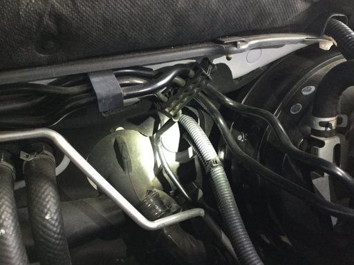

That would work. I ran 4ga. to my “sub buss” to under my drivers seat where it connects an Inverter, CB, 2M and a usb accessory port.CB86D964-82A2-474A-AEA8-8756DAA726F4.jpegD54A87B7-E643-49CE-83E5-19CA46F245BB.jpegB40DE579-69B4-4D82-BC60-EA7B2D579099.jpeg04A5EC7F-865B-4734-8A6C-C73B3FDA6C23.jpeg

That would work. I ran 4ga. to my “sub buss” to under my drivers seat where it connects an Inverter, CB, 2M and a usb accessory port.View attachment 131520View attachment 131521View attachment 131522View attachment 131523
That's a good idea. I never thought of running a subbus inside of the vehicle. I could then run another circuit to the rear of my jeep for the fridge and other accessories. It would eliminate most of the "small" wire from under the hood. I like the idea of busbar for under the hood but there isn't much room in a jeep.
