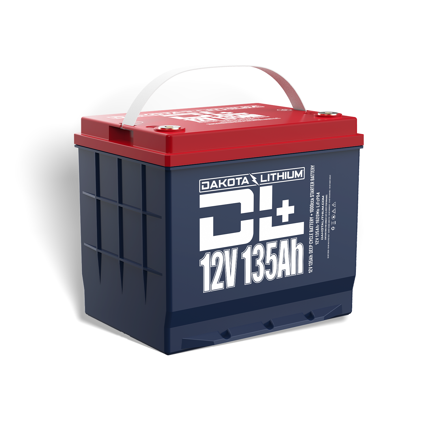

Dakota Lithium offers a starting battery… it’s expensive… and still not recommend for modern under hood applications.
