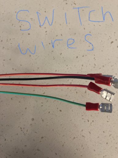

the rocker/power switch I have an aftermarket switch from RAGO that fits my Tacoma

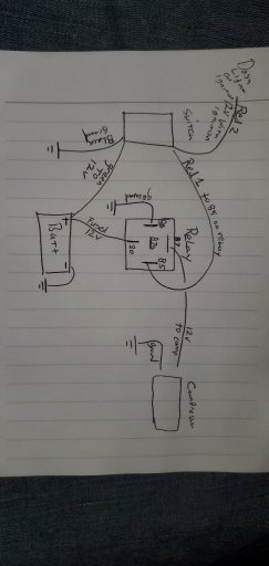

It will take some thinking and planning on your part heck i got a headache just coming up with that basic sketch. Basically take the instructions that came with the compressor and omit everything you dont plan on using.

this is what I'm working with do I still need a relay or do I need a different switch all together? thanks again for your help.

If you followed what @Boostpowered or I recommended then you will need that inline relay provided with the compressor. The thin red will energize the relay to allow juice to flow through the thick wires from battery to compressor. You should not need any other external relay.

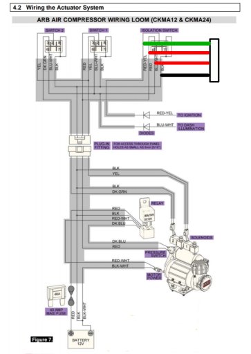

I am assuming a few things:
1. You are wiring a CKMA12 compressor
2. You have the ARB harness that comes with the compressor
3. This is the wiring diagram for your Rago switch
Even though the ARB harness has extra wiring for lockers it doesn't sound like you are using, you can still utilize the harness. Attach the ARB "Isolation Switch" wires to the Rago switch pigtail as follows:
ARB -> Rago
Red-Yel -> (#1) Green
Red -> (#2) Red 1
Blu-Wht -> (#3) Red 2
Blk -> (#4) Black
Tape off (with electrical tape) and secure the unused portions of the ARB harness: Switch 2, Switch 1, Solenoid 2 and Solenoid 1.
