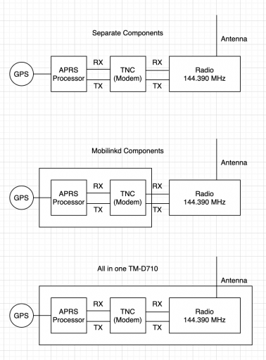

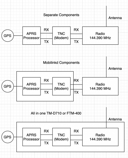

I'l cover three scenarios to explain how to get to APRS - forgive me if this is too low level but it provides a foundation to eventually answer your questions
Disclaimer: APRS is fun and neat but should not be considered a safety net for travels in remote locales; for that consider a satcom device
There are many other threads in this forum that discuss APRS - you would benefit from searching the OB forums, and the internet, to learn more since this is a big subject.
Before I define the scenarios I should define the bits and pieces in the drawring below
  • Radio - Ham radio able to transmit and receive on 144.390 MHz (in the US). Analog realm
    • A dual band radio is a great choice as it allows APRS and voice operation concurrently
  • TNC - Terminal Node Controller (or a modem). Converts between the digital and analog realms and vicey versey
  • APRS Processor - Understands the APRS protocol, receives/decodes, encodes/sends, communicates with outside devices like a computer or phone/tablet, connected to GPS - Digital realm
  • GPS - provides position data to the APRS Processor
Three scenarios
  • Separate Components - Each component is a separate device that are connected together
    • Probably not what you are looking for - bulky, lots of wires
  • Mobilinkd Components - A Mobilinkd serves as the TNC and APRS Processor and is connected to a radio
    • A good solution if you already have a radio. Requires some new wires to connect the Mobilinkd to the radio (mic and speaker), requires power to the Mobilinkd, pretty sure the Mobilinkd has a GPS but mine has been loaned out for about a year and I am tired. Requires dedicated radio since it connects directly to the radio's mic and speaker.
  • All in one - A radio such as the Kenwood TM-D710 or Yaesu FTM-400 which contains all of the components
    • IMO the best option as all components are contained together and a dual band radio can be used for both APRS and voice concurrently
Then there is software, which "connects" to your setup (APRS Controller specifically) and serves as the user interface. The all in one radios mentioned are able to serve in this role as well. You mentioned myAPRS which I am not familiar with - but that fits in here. There is a lot more that I could ramble on about but its been too long of a day and I'll allow you to come up with some more questions and try to answer those. I hope that this helps you understand the hardware required to play with APRS.
