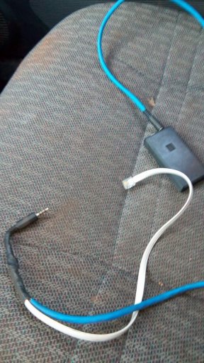

So I have an Icom 2730 and Mobilinkd 2.2 device being delivered sometime sooner or later (COVID19 willing). But I will need to make a cable to connect the devices together. Attached is a picture of the Icom Mic pinouts and the TNC instructions, it lists the pinouts for the TRRS output from the TNC.
I can wire an RJ45 if I know what to connect to which pin? Most of it is pretty clear to me but I am unclear on the grounds do I need to connect all the grounds to the same ground.
Ring 1 (TNC) to Pin 4 (RJ45)
Ring 2 (TNC) to Pin 6 (RJ45)
Sleeve (TNC GND) to Pins 5 & 7
Tip (TNC) to 3.5mm Ring 1 (Speaker)
Sleeve (TNC GND) to 3.5mm Sleeve (Speaker GND)
