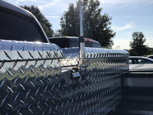

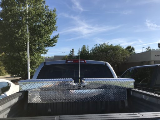

Sorry y’all. I completely forgot about this post. I ended up mounting the Diamond 770 with a modified mirror mount to the back of a cross bed toolbox that I found on sale at my local Tractor Supply. I needed a box anyway, so.... Works really well. SWR is less than 1.5 on both 2m and 440. The repeater I hang out on is about 40 air miles from my house and I get full quieting most of the time running 50 watts. Highly recommend this setup if you have or in the market for a toolbox and a no ground plane antenna.
ETA, I’ll snap a pic here in a bit if I get a chance this afternoon.
