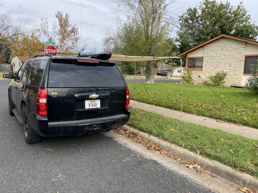

I have an extra awning I am wanting to mount on my 2001 Suburban. Any ideas on how to mount a Rhino awning to the factory roof rails?

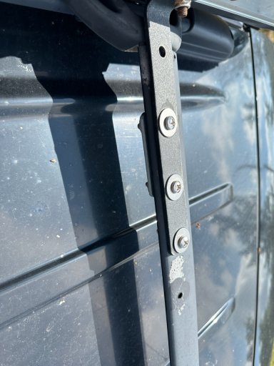

I mounted one to my gmt900. I used L brackets and just drilled the cross bars. They’re cheap enough to replace from eBay.
