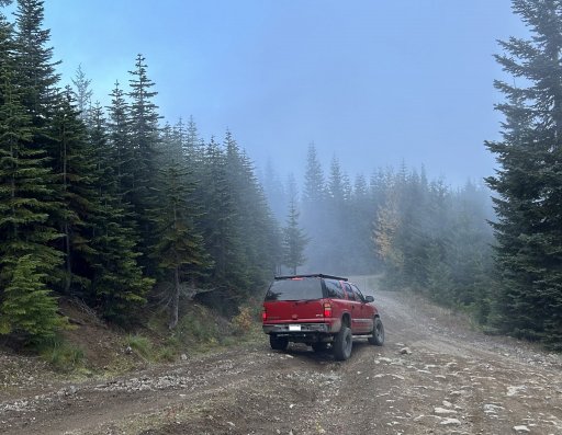

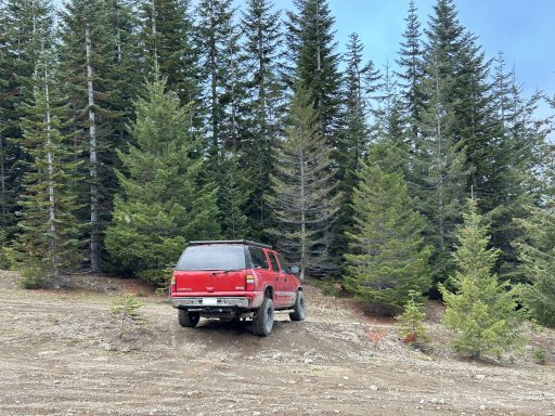

I know this is an old thread, but have you found your truck?
I have a 2004 Yukon XL 2500 with the 8.1L and 4:10 gears. It gets used quite often for towing, off roading, and hauling and has easily been the best truck I've ever owned. PM me if you want any specific info.
