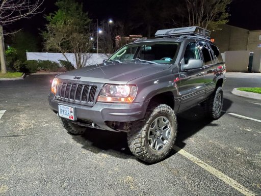

I bought this totally intending to just play in the rocks. Than wife and I are planning to move and where we are looking it looks more like overlanding trails. So I am going to be building her for Over landing. I have to adjust a few things inside but other than that I think she will be totally fine. I have a 4" RC lift Front Sway bar Disco's, Rear swap bars have been removed. Replaced the rear axle to the Dana 44a and front axle also replaced to match gear ratio. I only have now 3.73's for gear. I want to go up to about 4.10's possibly taller. Right now I am tossing around to build a trailer to go with her or just be in her. It will be mainly me going out on the trails. I may have my wife with me some times. So its still in the air on if I am building a trailer or not. :-) The rims a tires are 17" Rubicon wheels with 255/75r17 Wrangler Dura tracs. So far I am very happy with her.

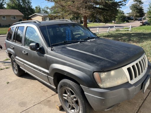

Here is a picture of the day I bought her.

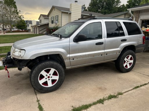

Here she is now.
As always a work in progress.
