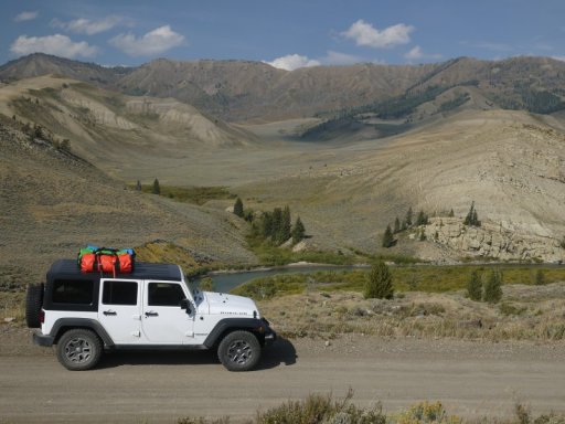

Yes, an excellent alternative to a roof rack. I went with this concept. I was going to spend big money on rhino-rack but conceived the idea of strapping waterproof duffel bags to the roll bars.
95265
Keeping it light is the key. What I have up there is tent, sleeping bags, pads, and hiking gear for the family in 3 bags (120L) at around 33lb in each, so total of 100lb sitting on the hard top fibreglass canopy, bit much, but it is spread across a surface area.
Thoughts...
I prefer to split it up into 3 duffel begs instead of one big one:
pros:
- easier to pack in basement and load
- easier to unpack around camp and carry gear to tent spots
- small enough to store empty bags in tent vestibule
- lost of different duffel bag options on market
- option to put it inside if room is available
- if security is a concern (when away form rig) you can put them inside
- duffel bags are not specialized gear, so if you change your mind, have other uses
cons:
- more expensive overall
- security: easier to steal smaller bags
- takes longer, more fiddly, to strap
- more straps around making more noise

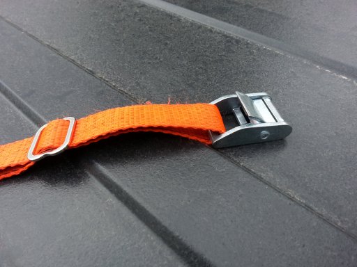

That’s really cool could you use a ratchet strap instead or do you think that would damage the gutters ... would you trust putting a Jerry can up there
A ratchet strap might be over-kill in this situation. The Rightline system lined above uses a basic plastic buckles/tension-lock. I used metal spring buckles for added safety, they don't slip as much, and I used a metal lock, making it adjustable, and not requiring sewing.

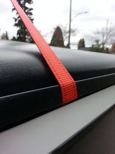

The ends of the 4 strap have a loop sewn and girth hitch into the inside roll bar providing a very solid anchor. It comes out the door at these angles:
95296
I'm not concerned about the roof gutter at all, it is a compression force inwards on the gutter, and there isn't enough tension in the strap to cause a problem. There is no need to ratchet it up, all the straps need to do is keep the bags from sliding off and moving around, due wind resistance or side to side off-road action, with the weight and friction of the bags on the roof providing a good amount resistance force. With the three bags, the inner one doesn't get much downwards force at all and sometimes is pushed back by wind till the bag's handles/straps catch.
One area of concern is the total weight on the fiberglass canopy, you can see it flex a bit in the middle, when loaded. So if you ratchet it up and thus apply excessive downward force it might add to the problem. However, my bags rub against each other and I can see evidence of hot spots.
In hard core, prolonged off road trails, what kills roof racks is the violent side-to-side action, and what fails is not the roof rack, but the legs/attachments. This is one reason I wanted to try this system because there is no rigid attachments to fail. But I don't have enough experience with this system in that environment.
