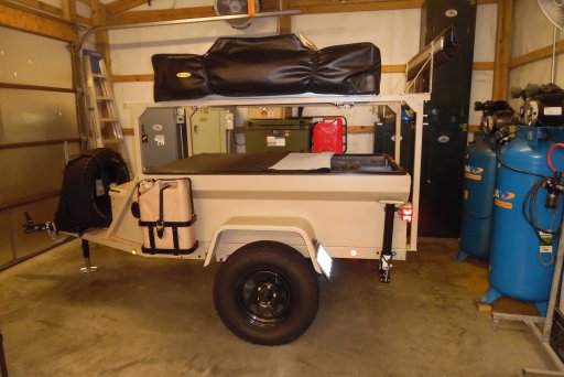

finished my bracket modification to my trailer. I swap out the red Midwest 5gal. Jerry Can for the desert tan Scepter 5gal Can (will be used for water). I had to extend the Smittybilt bracket (that goes over the top of the can) by adding more metal & tweaking (bending) the angle more to clear the Scepter lid. I welded the pieces added, media blasting the metal clean of the old paint then primed, base paint black & used the same clear coat I painted the trailer. I changed out the strap from red to black.
1st photo before with Midwest 5gal. Jerry Can. I also camo printed (hydrographic process) the license plate frame in Natural Gear Camo for some bling.
