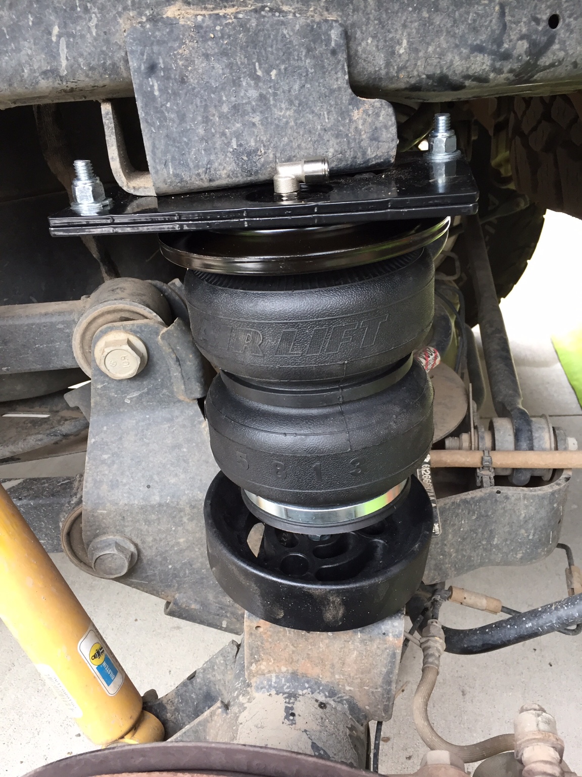

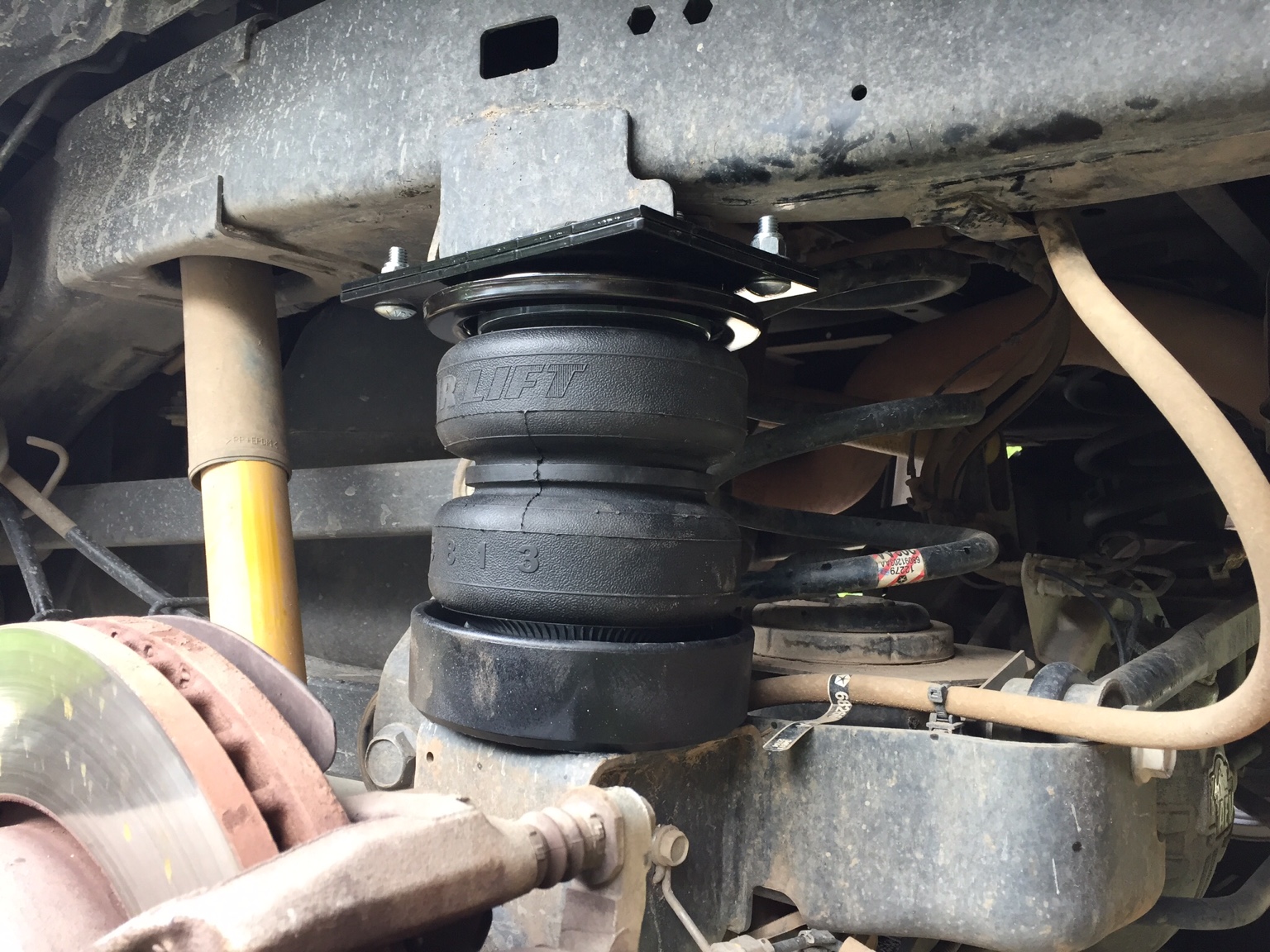

I'm running the AirLift 5000 Ultimates and Daystar Cradles on my truck, really happy with the install compared to the firestone installs I've seen on the same truck, not sure how it compares on the Toyota. On the dodge they utilize the stock bumpstop mounting locations, I drilled and tapped the bottom pad to directly accept the cradle instead of using the brackets that clamp around the axle tube. In my case I wanted as little bracketry in between as possible so as to not limit up travel any more than necessary.

What exactly do the Daystar Cradles do? They just look like mounting brackets
See the top photo where the bag is hanging suspended above the cradle? They allow full axle droop without stretching/damaging the bag or limiting down travel. It's just an independent base that guides the bag back into position instead of hard mounting it.
