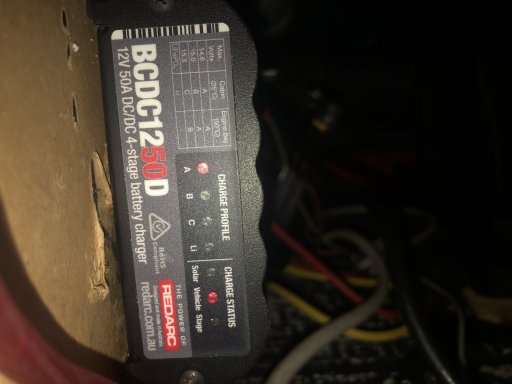

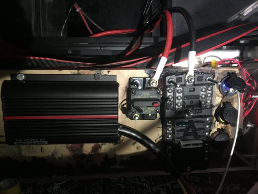

I was a cheap bastard and I tried what reaver posted, mine was 460 W. You can find them cheap, and they are cheap for a big reason. They are very slow to charge. When you leave from home, all is good. After you sit one day in one place, to charge them via a normal cigarrete plug thingie will take 8 h, that means you will have to drive 8 h. Even on a camp site with power connections they take 4-5 h. Most of them recommend that you don't charge and have consumers on them same time. They work, but most likely they will break fast. It is a good unit to have a as a back-up, it is light and mobile, most cand be used as a jumpstarter as well, so they are good to have in a pinch.
Than I got 105 AGM with a Voltage Sensing Relay, which is fairly cheap. The issue is your AGM will never be fully charged, a normal alternator wil not put out the 14.5V that an AGM will require to charge to 100% . Charging is relatavily slow, but much better than before. So you can still use it, but have in mind perhaps an even bigger battery. but that means more weight. If I wanted to stay 2 days on one spot, was impossible, had to start the engine and keep it running for 1 h at least.
So I bit the bullet and got a dc-dc. In 20 min the AGM is fully charged. I have a solar panel I can connect to it, but now since the battery is is charged much better, I will last 2 days anyway. I did some experiments with a 100w soalr panel, in ideal conditions will charge a bit over 1 amp so that covers whatever it is consumed by the fridge during the day and even charges the battery a bit, so in the evening has mor charge than in the morning even if I use it all day and charge phones on it, etc.
You can put an AGM in the engine compartment, but if you look at the spec sheet of any AGM it will half the life of it easy. Heat will kill even Optima or other manufaturers thay say that they are ok to use in the engine comparment. It will work but instead of lasting a good 7-8 years, will be done in 4 or less.
Redarc is expensive but there are other ones who work well if they are not in the engine comparment like Victron, CTEK, or other brands. A 20 amp is more than enough for 1 auxiliary battery.
So buy once, cry once.

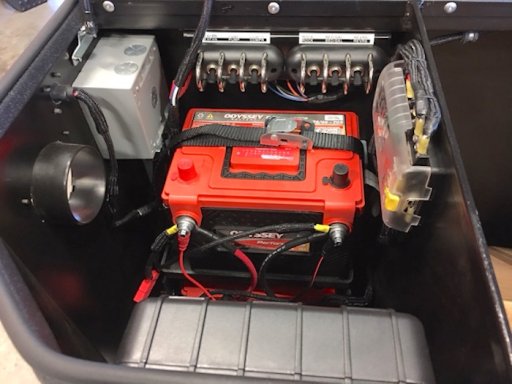

@Toolman - It sounds like your intended use and electrical demand is about the same as mine. If you like running wire and creating your own install, you will probably enjoy this type of build.
What I did is this: Replace starting battery with a parts store AGM. Install second house battery with a parts store AGM under the hood. I am currently running AGM's from Advance Auto. Both batteries are pretty inexpensive and you can get a discount by buying them online and picking up in the store. These batteries wont win any AH awards, but my house battery will run a fridge for 24 hours in the summer without a supplemental charge.
The batteries are connected together with a 500amp solenoid via cables I built. The solenoid is wired to a switch inside. The switch can trigger the solenoid with an accessory (key on) power source so it activates when I start the rig, or the solenoid can be triggered by a permanently on (direct to house battery) power source which is useful for a self jump start or for any other reason you want to connect the batteries. The best part? I know exactly what is happening to my batteries and when vs. being surprised due to a smart controller malfunction.
Here is a rough outline of how I approached installing the batteries. I'd guess I have roughly $4-500 in my installed system:

My theory is that with a simple set up I could easily field repair or field bypass any part of the system without an issue. I know most of the aftermarket options are well built and I researched them heavily before starting my own build. There are instances right here on OB where somebody installed a kit (or had it installed) and ended up with dead battery(ies) in the field.
What's the purpose of the voltmeter interrupt switch?
It turns the voltmeters off.
Did you create a material list (brands, where purchased, etc.)
I did not, but most of the supplies came from Amazon so I could round up some details.

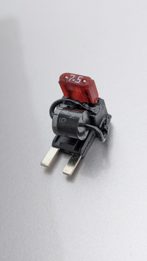

Does you house battery only charge from the alternator? Do you get enough voltage from your Land Cruiser alternator to full charge the AGM batteries? I've heard that a standard alternator does not put out enough voltage to fully charge AGM batteries.
I have AGM's for starting and house. They both charge from the alternator. I installed a diode on the alternator voltage sensing circuit. This tricks the alternator into charging at a higher voltage, about a 0.5 volt increase. I now see between 14.2 and 14.7 volts charging voltage from the alternator.
