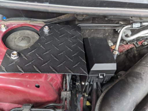

And I went the Amazon prime route. I read all the reviews and chose the Nirider 6 gang system. It is very well made, heavy guage wiring on the battery side, 16g fused hot side. It has a single flat cable (quite long) that connects to the switch panel inside. The switch panel is where it sucks some. Its rinky dinky with plastic pushbutton clicky squares. The lighting inside the switch is fairly bright too.
I did not mount my switch instead I have it loose under my tilt steering area where I can easily access it without having the annoyng green light in my eye.
not the best pic of the unit, as I am not a big picture taker... but I had to make a bracket to mount the fuse box.
Nirider 6 Gang Switch & Fuse box

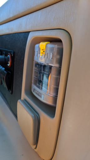

I also used a Blue Seas fuse box, but I installed it in an unused cup holder in the cargo area:
For more information, you can check out my dual battery install here:
